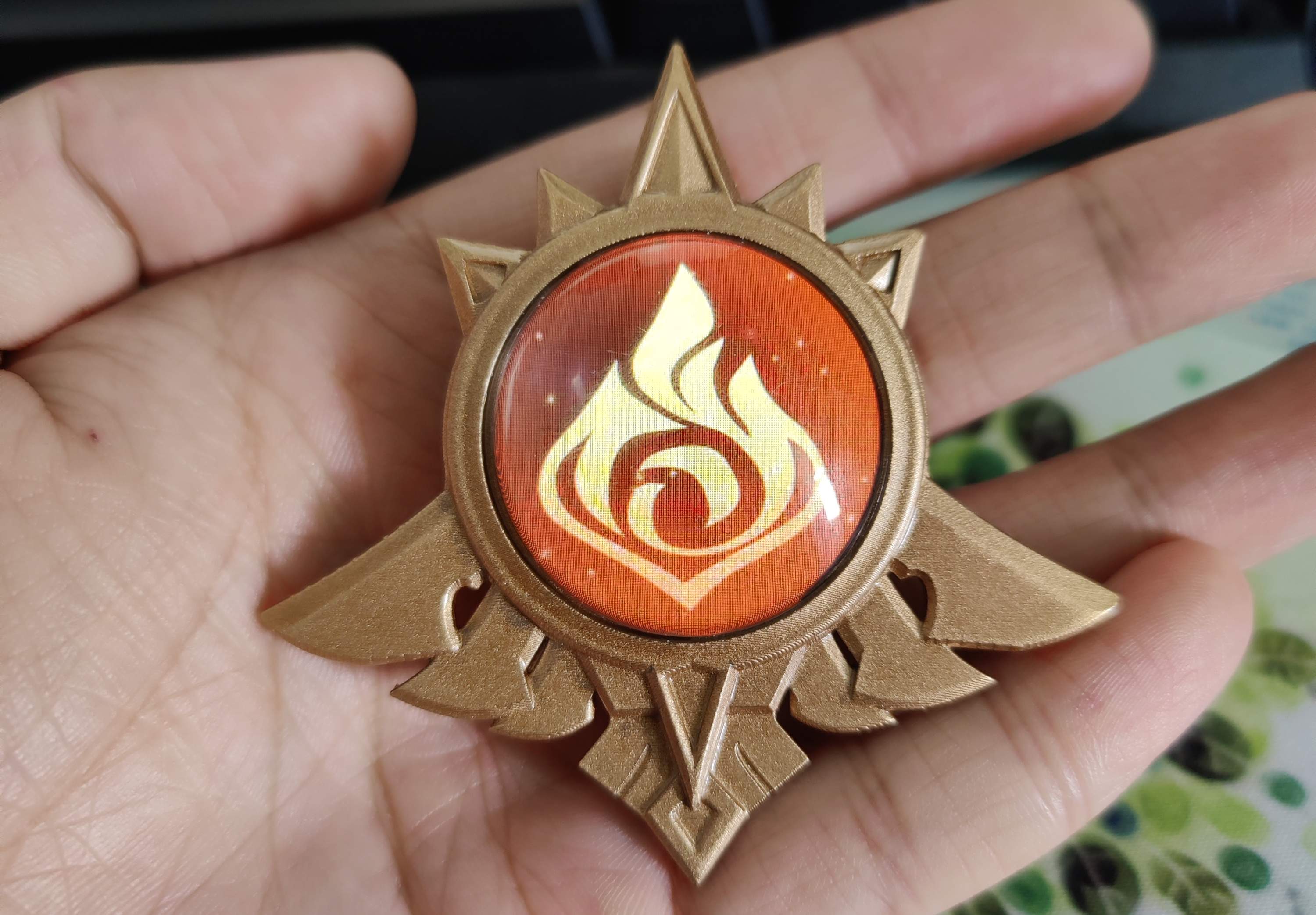

↑Assembly renderings, from left to right, back cover-battery-PCB and screen-casing-plano-convex lens
Effect:
Picture 5 shows the outdoor effect on a sunny day, which is not very nice.
The effect of installing the key chain:

The plano-convex lens (glass) is glued on. Use a toothpick to pick up a little glue and apply it to the edge of the shell. Apply a full circle before putting the lens in.
(Please use hard glue for glue. Do not use soft glue, which is a glue that becomes solid after curing. Do not use 302AB glue. This glue does not stick to glass. Before purchasing UV glue, ask customer service whether it is hard glue.)
There will be a 1.5mm thick gap between the back cover and the core board. You can stick 2mm thick buffer foam inside the back cover (as shown in the picture)
