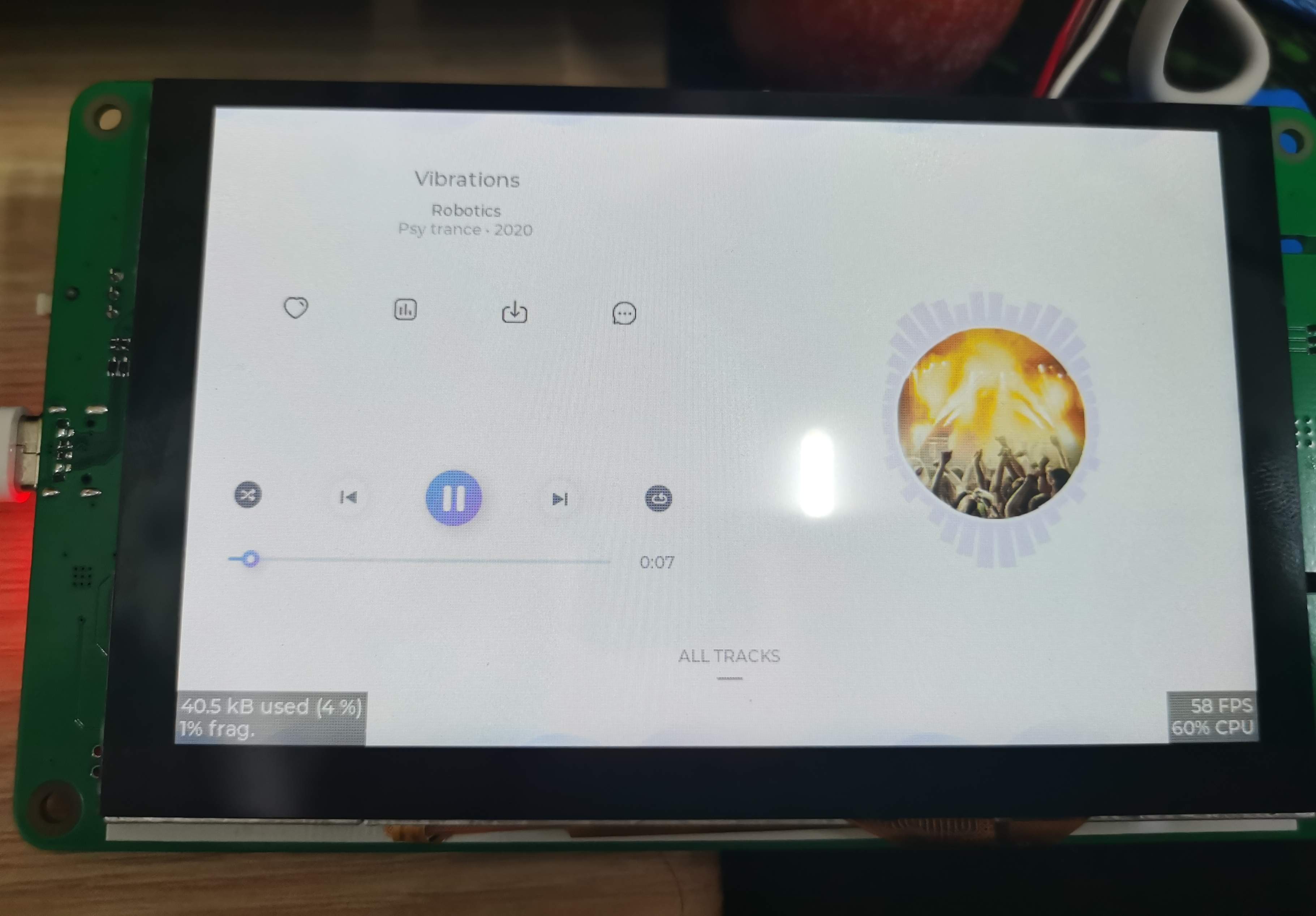

toothache
Allwinner D1s isolated serial screen
Video demonstration https://www.bilibili.com/video/BV1yB4y1y77y/
Please use the Gerber proof uploaded in the attachment (Project Outputs for F133_LCD.zip)
F133_LCD.zip is the AD project file
tina_d1s-nezha_uart0.img is the test firmware, and the output serial port is UART0 (PF2, PF4)
screen purchase address 5-inch IPS capacitive touch LCD display 5-inch high-definition 800X480RGB interface plugged into 40PIN full-color screen - Taobao (taobao.com) (no interest relationship with me)
Firmware download: You need to download phonixsuit, The board is connected to the computer via USB, phonixsuit selects the corresponding firmware, press and hold FEL and RST at the same time, then release RST, then release FEL, the firmware will be automatically downloaded to FLASH
LVGL demo: use USB to TTL to connect the board, enter lv_examples in the terminal
now Problem: The fuel meter bq27542 has not written a Linux driver, but it is debugged normally using EV2400.
If you need more related tutorials, please go to the Allwinner Developer Forum to find out. If you
have any questions, you can join the Q group 334245983
