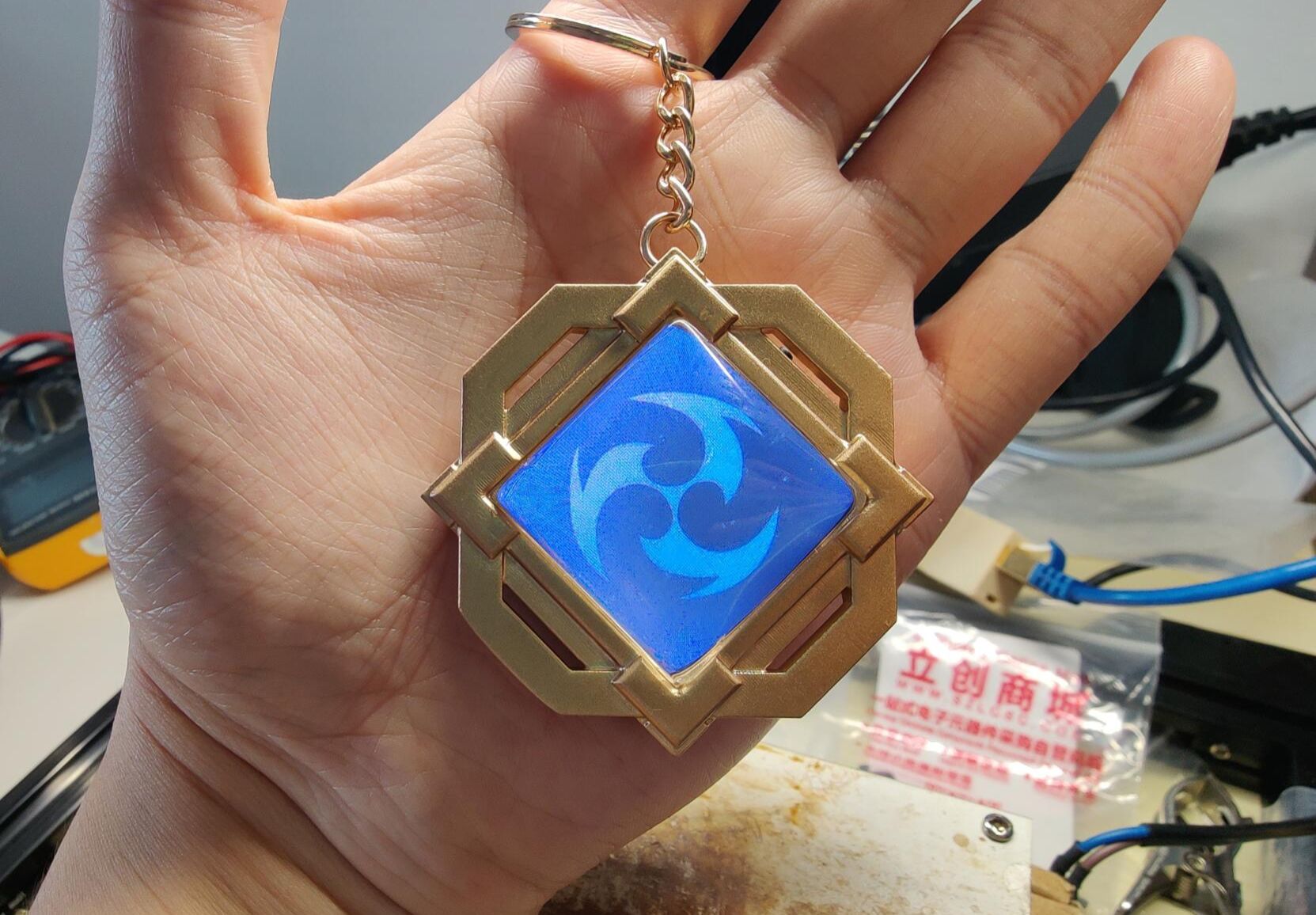

Project Description:
This project is based on the Arduino IDE environment
The hardware and software parts of this project are open source based on the GPL3.0 open source license (can be modified, shared, and commercially available, but must be open source). Please follow the GPL3.0 open source license rules for secondary modifications.
GPL3.0 license introduction: http://www.gnu.org/licenses/quick-guide-gplv3.html
Since the shell is modified based on libc0607 , this shell is also open source under the CC-BY-NC-SA 3.0 open source license (can be freely modified and shared, but not for commercial use!)
CC-BY-NC-SA 3.0 open source license introduction: https://creativecommons.org/licenses/by-nc-sa/3.0/
I asked MiHoYo via email, but it cannot be counted as a fan work, so if you want to sell it, you can weigh it yourself.
ArduinoIDE: https://www.arduino.cc
The project uses the Arduino_GFX library to drive the screen: https://github.com/moononournation/Arduino_GFX
Video playback code comes from: https://github.com/moononournation/RGB565_video
The shell is based on the second modification of the Eye of Liyue shell of libc0607 , address: https://github.com/libc0607/esp32-vision
The eye of god material comes from Kira , the master of UP station B , material address: https://b23.tv/m50Vcry
Then I use AE to add some particle motion effects. The AE project file will be placed in the attachment (the AE version is CC 2017. Please do not use an AE version lower than CC2017 to open it. You need to install the TrapcodeParticular particle plug-in). At the same time, various The 60-second dynamic video file of the elements is convenient for everyone to use editing software to combine and modify at will.
I have open sourced a round one before ( https://oshwhub.com/Myzhazha/esp32_pico-d4-video ), this time it is a square screen
The welding was too difficult last time. In order to reduce the welding difficulty this time, the main control used the ESP32-WROOM-32U module, and all resistors and capacitors used 0603 packaging specifications.
Super detailed production tutorial: https://www.bilibili.com/video/BV1HS4y1b7tQ
If you have any questions, you can join the group and ask: 636426429 (Do not directly copy the group number to search, there is a chance that it cannot be found, enter the group number manually)
Battery life: The battery life is about 4 hours when the screen is always on.
Main control: ESP32-WROOM-32U module
Screen: 1.54-inch ST7789 screen
Regulated LDO: RT9013-3.3
Charging IC: TP4055
Charging interface: Type-C
Battery: 602828 lithium battery or 603030 lithium battery or 603035 lithium battery (battery thickness is less than or equal to 6mm, length and width are less than or equal to 32mm respectively)

6. Assembly:
When assembling, please align the Type-c interface first and then press the other side
The plano-convex lens (glass) is glued on. Use a toothpick to pick up a little glue and apply it to the edge of the shell. Apply a full circle before putting the lens in.
(Please use hard glue for glue. Do not use soft glue, which is a glue that becomes solid after curing. Do not use 302AB glue. This glue does not stick to glass. Before purchasing UV glue, ask customer service whether it is hard glue.)
