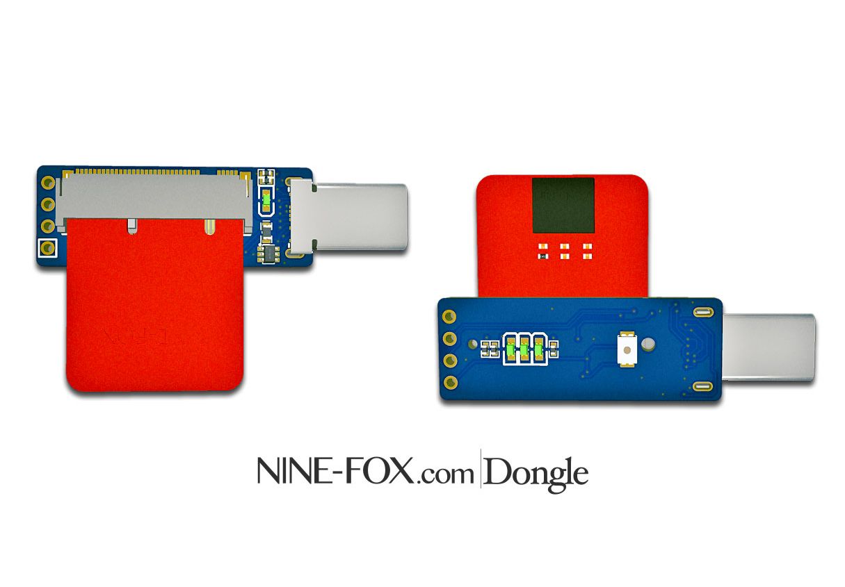

In order to solve the above problems, the official provides a 2.4G Bluetooth adapter to connect Bluetooth keyboards in wireless mode. Currently, it only supports Jiuwei series keyboards. Features are as follows:
- Adapted to the Bluetooth 5.2 standard, providing the highest 2M rate under Bluetooth 5 to connect to the Jiuwei keyboard
- No need to install any driver, plug and play
- High-end version core module reuse, an M.2 customized core board supports Jiuwei keyboard at the same time The tail series keyboards include 7W, Pad R2, DIY functions, etc., and the firmware is unified, so there is no need to re-flash the firmware when switching, and it can be plugged in and used. See https://nine-fox.com/docs/diy
- Supports keyboard configuration in wireless mode through the web page, access address: https://nine-fox.com/editor
- The peripheral circuit is open source and can be freely used as needed Customize the required interfaces, such as TYPE-C interface, USB extension cable, etc.
