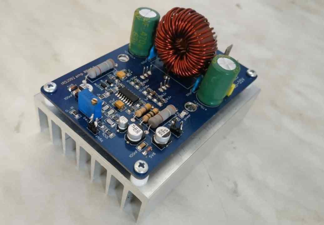

Class D audio power amplifier based on IRS2092 chip. The output power is approximately 250-300 watts per 4 ohm load, the recommended operating frequency is 350-400 kHz, and there is short circuit protection within the load. This circuit is designed to be used with the field effect transistor IRFB5615, when using other transistors some denominations need to be recalculated. An amplifier with the correct components will work immediately, simply adjust the desired operating frequency via a variable resistor. The amplifier's power supply requires a power supply with a bipolar output voltage of 35-50 volts (up to 55 volts allowed), 2.4 amps per channel, and a low voltage supply of 12 volts to power the logic. The choke is wound on the core wire T106-2 wire 1 mm number of turns 51
