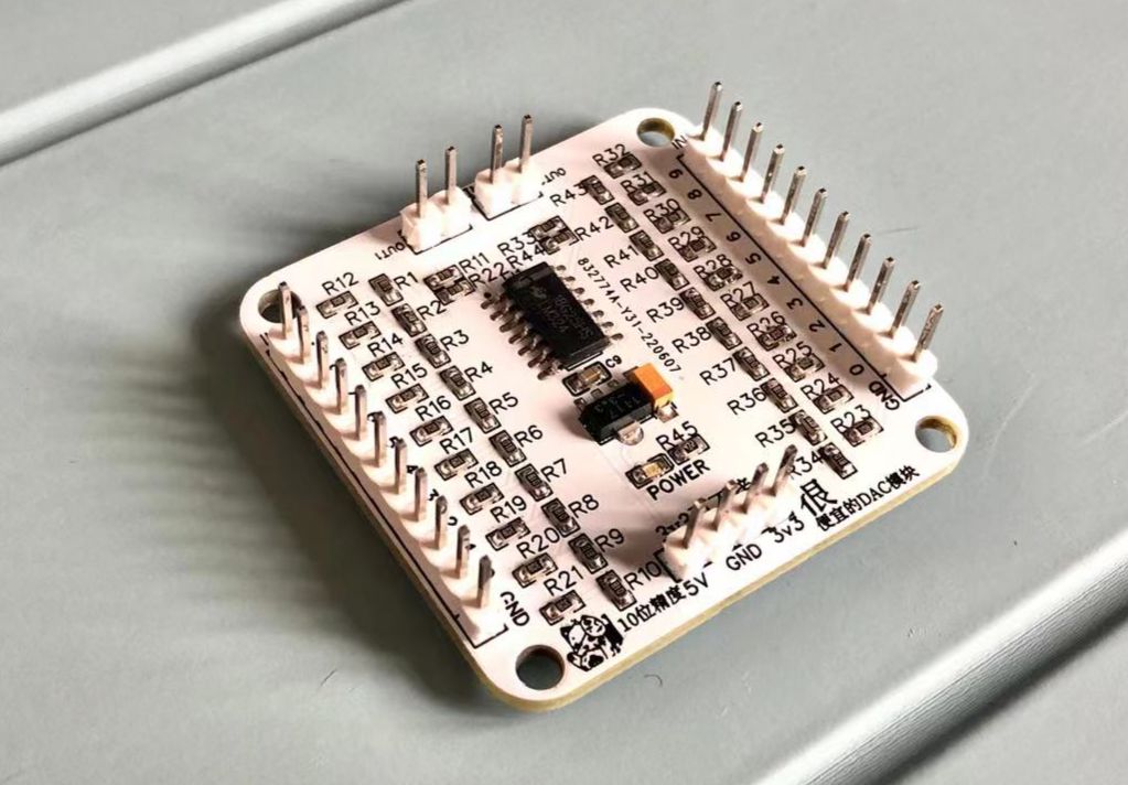

Dual DAC module (inverted T network) suitable for FPGA
Video display
B station video  B station video portal (click me!!)
Physical display
                             (front back)
Instructions for use
The left and right sides are signal inputs, with 11 pins on each side. The bottom is the ground wire. The weight increases from bottom to top.
The power supply is provided below and only requires 5V and GND.
The upper part is the analog output, and out1 and out2 correspond to the left and right pin headers respectively.

Appendix 1: Special design:
What if one of the amplifiers in the chip burns out?
Just remove the chip and solder it in the reverse direction (flip the x-axis)! (LM324 integrates 4 amplifiers, only 2 are used here) (doge
