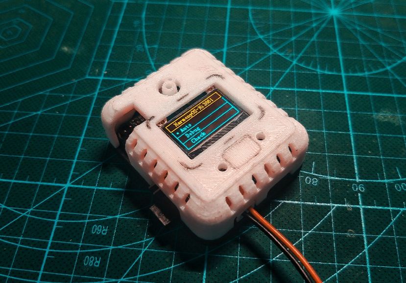

8 Physical display
(1) Main components:
(2) Power-on interface display:
[The demonstration video is in attachment V1...]
