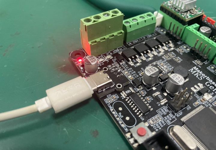

USB_B_USB_C
1. This module is directly modified from the B-port package, and the PCB and B-port sizes are the same.
2. When welding, it is recommended to use pin headers to ensure a firm connection, and a piece of tin can be used for the fixing holes on both sides.
3. In order to ensure that the data port is correct during design, resistor packaging is selected and needs to be welded by yourself.
4. If it cannot be used, it has nothing to do with me.
参考设计图片
