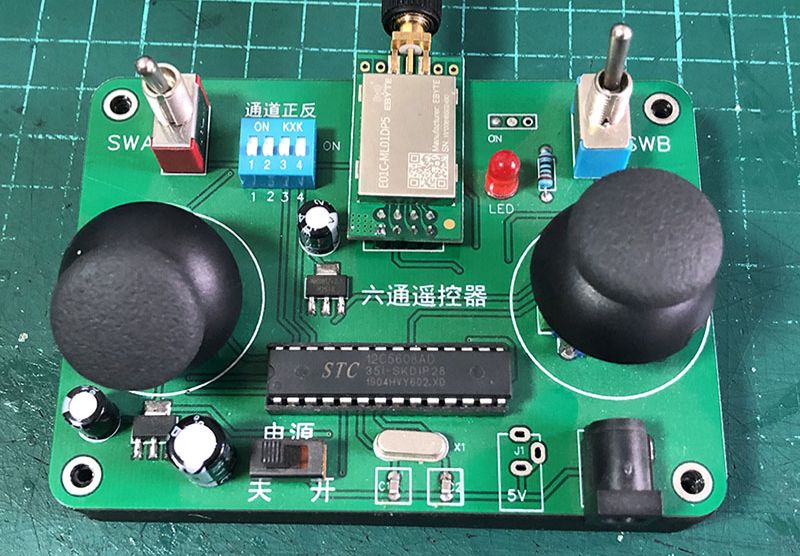

The open source remote control of Loli Generation has been board-certified and can be used directly.
advantage:
1. Fool-type remote control, plug and play without frequency linking, no display screen;
2. Reasonable and regular layout, good signal, small size, easy to modify;
3. Transmit power supply 2S~3S, 7-12V;
4. Support a variety of NRF24L01 plug-in wireless module;
5. A total of 4 proportional channels, 2 switch channels, and 4 reverse switches;
6. Plug and play, convenient and stable, low cost and small size;
Disadvantages:
1. If two sets are used at the same time, they will move at the same time and interfere with each other;
2. No fine-tuning function.
