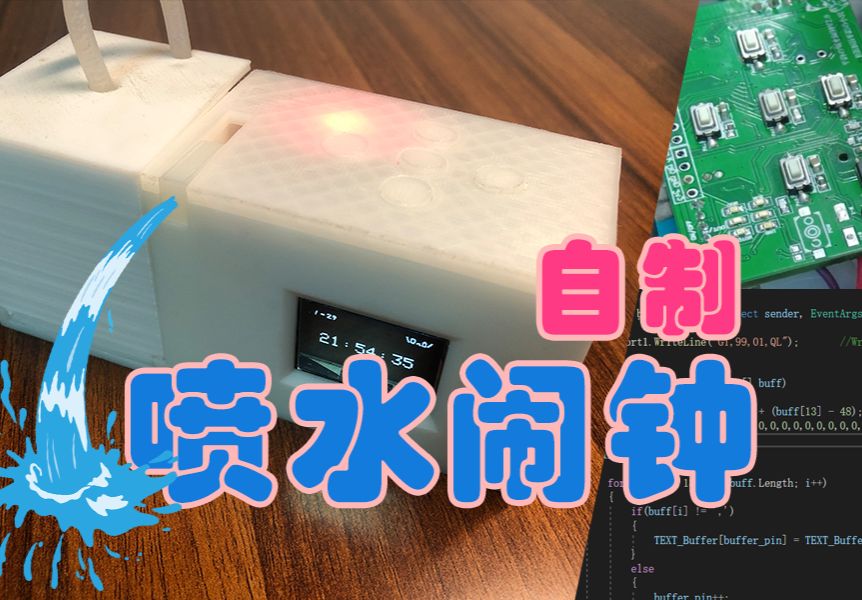

BiliBili open source water spray alarm clock based on GD32
Water spray alarm clock based on GD32f103
Zero and finished product introduction video:
   Please move to station B:
          https://www.bilibili.com/video/BV1Aq4y1h7gw#reply100466243184
1. Project Overview:
  This project only describes and explains the hardware (circuit) part. For other aspects (such as shell modeling, programs, etc.), please see  part 4, shell, programs and other other information .
The currently implemented functions are as follows:
  Hardware: Ring reminder, water pump spraying water, display graphical interface, button menu control, rechargeable (personal test lasts for more than 24 hours, but it is still recommended to plug it in)
  software:
     Microcontroller:
            The main interface (dial and digital styles) displays time, three sets of independent alarm clock settings, independent switch of water pump and ringtone, time setting, date setting, automatic time calibration, test mode (testing water pump ringtone by pressing buttons), etc.
      Host computer (written in C#):
            Real-time display of alarm clock information, reading of alarm clock memory, setting of all functions, and one-click synchronization of computer time and date to the alarm clock

5. Results display:
参考设计图片
