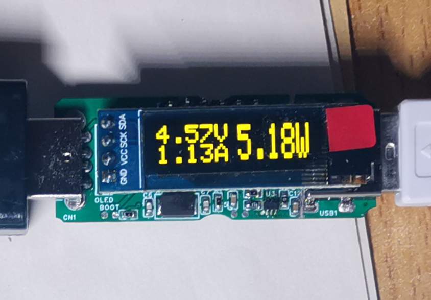

#The7thLiChuangElectricityCompetition#USB power meter
The question requires
a USB power meter to measure the voltage and current of the load and calculate the power. The
analysis
circuit of the question can be divided into two types of circuits. One is the 3.3V peripheral power supply circuit of digital chips such as microcontrollers; the other is the load sampling circuit, including resistor voltage division voltage sampling and load circuit low-end current sampling.
Schematic design description
LDO voltage drop circuit:
Microcontroller and peripheral circuit:
Sampling circuit:
OLED display circuit:
PCB design description
Layout: Pay attention to placing the power supply filter capacitor of the digital chip as close to the power supply pin.
Wiring: The default length of ordinary signal lines is 10mil; the load circuit requires more than 20mil due to the large current.
Software instructions
Use the official reference code, but pay attention to changing the pins, otherwise the screen will not display.
Physical display description
test results:
jNVCgO5CXKSbxFZC2svvRRNMl5TZTldJIZXA0FOF.pngLoad parameters:
N32G430C8L7-USBMeter.7z
PCB_PCB1_2022-11-05.pdf
BOM_Board1_PCB1_2022-11-05.xlsx
Altium_#The 7th Altium Power Competition#USB Power Meter_2022-11-05.zip
PDF_#The 7th Lichuang Electric Competition#USB Power Meter_2022-11-05.zip
BOM_Board1_#The 7th Lichuang Electronic Competition#LCSC_2_2022-11-05.xlsx

pZKVP5gFQ4hgs8jp3KyUTleoSkqJgCZbMs8cP6eV.png2. In order to adjust the resistance value of the current sampling resistor, you can choose to weld the resistor R*. The purpose of this is to target different current measurement ranges. The default 10mΩ resistor R1 is more suitable for large current measurement (up to 6A). When it is necessary to measure the power consumption of low-power devices, you can choose to weld a higher resistance resistor R*, such as 100mΩ, to improve the measurement accuracy of small currents.
rlwDSWTuInna73RSn2uQ8Zehu2af8Xxm0LpqU9rx.png3. Switch SW1 is used to switch the power supply of the power consumption meter. This is very necessary - it can avoid the extra current consumption of the external power supply, and it can also avoid the high voltage of the external power supply from burning the power consumption meter. When measuring the power consumption of a 5V powered USB device, the power meter can be powered directly by the TYPE-C port and output power at the same time without connecting VIN+ and VIN-; when measuring the power consumption of a higher powered device (voltage>6V), it is necessary to connect the power supply through the VIN+ and VIN- ports, and output through VOUT+ and VOUT-. At this time, the switch SW1 needs to be switched to lithium battery power to avoid damage to the device.
7SA8ceSVydLXbg0pFtBlznku7m5cG2rMGO8T2mlv.png4. After testing, the maximum external power supply voltage is 30V, which is mainly limited by the ratio of the voltage divider sampling resistor R10/R11. If you need a higher voltage measurement range, you can increase the ratio of R10/R11, and accordingly, the voltage conversion value in the program also needs to be modified accordingly.
5. An additional IIC interface is added to the right side of the power meter, which can be connected to the temperature sampling module (AHT20) of the IIC interface to realize the function of ambient temperature calibration, but this function is not currently implemented because the selected sampling resistors are basically low temperature drift resistors, and the current use environment is not so bad that additional ambient temperature calibration is required.
*5. The software part
is fully compatible with the program in the USB ammeter case provided by National Technology. Although there are some differences in circuit design, including the power supply part, interface part, sampling circuit, and the display module uses a 0.96-inch OLED, it does not affect the display. The program only fine-tunes the error ratio during sampling, which can significantly improve the error in a larger measurement range. It should be noted that the software design provided by National Technology also uses an internal crystal oscillator source, that is, no external crystal oscillator is required.

*7, Competition LOGO Verification
By comparing the measurement data with the power analyzer, it can be found that the power consumption meter has higher measurement accuracy, with an average voltage error of 1.2% and an average current error of about 1%.
TQUJagucP7RWo5Bd6LiYWLkJn9yVrP1B17pt9KA3.pngX9LJJNkQxJ0ho5SmYry0mYcH8kEH7jsSUQb3VVDM.pngxGRwk0Njn7Rul2PXHvNeCRBRKFps3QpBkYQfS9dk.pngxDFHxw7wbBUQ34JxWkhkrPmIr5LPqGOkHmbHCLdc.png* 8. Demonstrate your project and record it as a video and upload it
