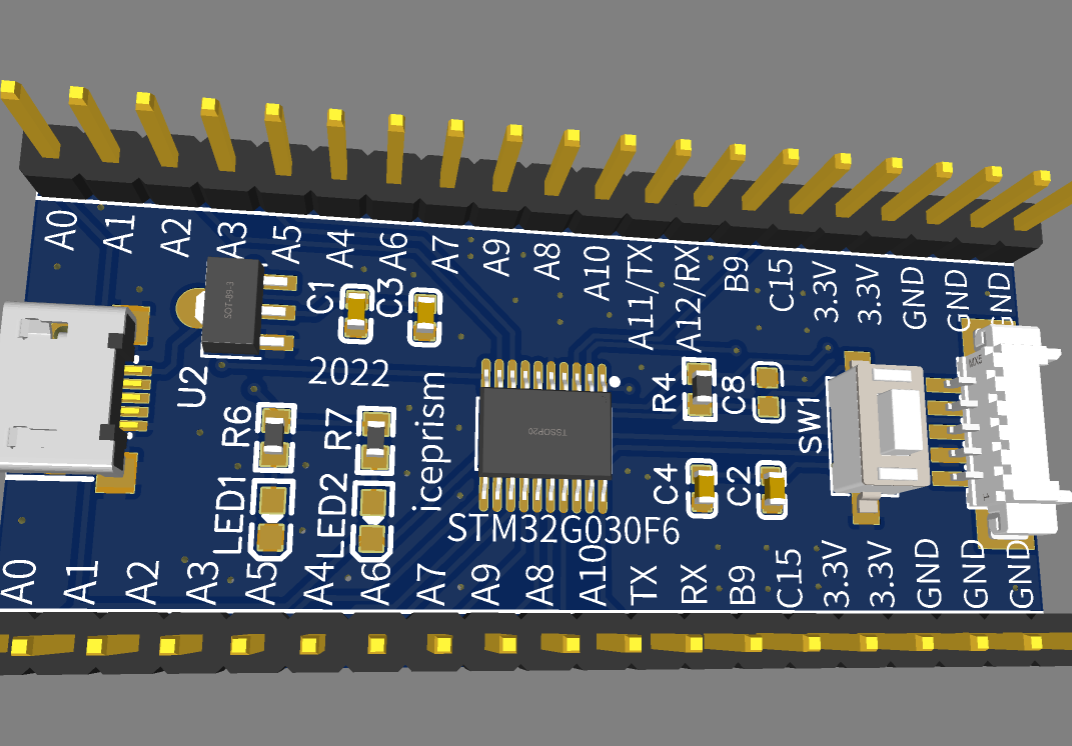

STM32G030F6P6 core board
The G030F6P6 of stm32 Taobao has less than 3块钱15 ios per piece, and basically it can be used for simple projects!

Ceramic capacitors cannot be used in the LDO of HT7333. Can cause oscillations, causing circuit instability, ADC interference, and rapid battery drain. I suffered a huge loss on the project. Either use electrolytic capacitors or tantalum capacitors.
Burning verification: The board has reserved swd burning interface, use stlink-V2 to burn
keil burning passed
arduino burning passed
Keil burning:
Use cubemx to create files, the path must not contain Chinese characters
After that, just open keil programming and burning.
Arduino burning:
This is a little troublesome.
First post the official: https://github.com/stm32duino/Arduino_Core_STM32 support list
arduino download development board
Tutorial from the boss: https://www.cnblogs.com/GeGeBoom/p/14014591.html
Install the STM32CubeProgrammer software on the computer and configure the system environment variables
Finally, restart the arduino and you can start happy programming. You can also download the program through swd.
