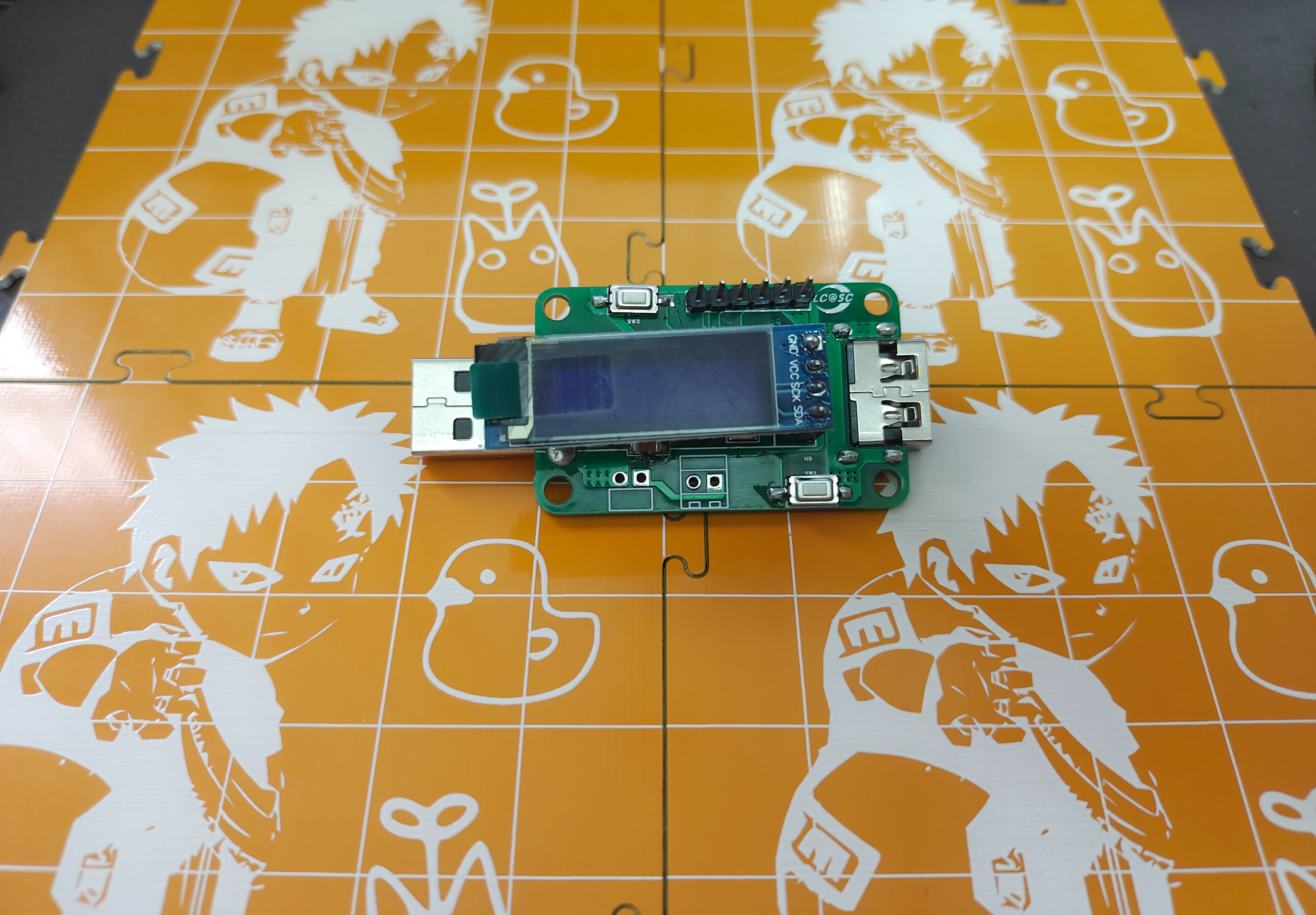

* 1. Introduction to project functions
1. Realize voltage and current meter functions
2. Realize QC2.0 deception
3. Multiple output interfaces, which can be used for various electronic development work

* 4. The hardware part
is developed using the professional version of LiChuang EDA, and materials are purchased in LiChuang Mall.
NG5rW5mMcpkWtaWmdo3a8Vr16AoIRhMSbyK5190Y.pngThe above picture is the overall design schematic of the project, which is developed based on the open source project of the training camp. The basic part will not be introduced, and the video explains it very clearly.
xPrLpL7W2dmZjhB4tZzTcZCEfl5pngmeJVlM1VT4.pngThe voltage regulator circuit adopts a more conventional solution ams1117, which can accept a wide range of inputs, so that the deceptive voltage or the normal connection of 5V can meet the design. The input and output of the circuit are connected to a large capacitor and a small capacitor, so that the frequency characteristics of the power supply are better.

From the table, we can see that the output gear position depends on the voltage of D+ and D-. The IO port of the microcontroller usually has three states: input, output, and high impedance. Through the combination operation of the IO port, select the output 3.3V or 0V, and then obtain the required voltage through a simple voltage divider circuit.
There are two questions to explain here.
1. The official recommendation for the current sampling chip
    is INA199B1DCKR. Since it is out of stock, I bought INA199A1DCKR. Pay attention to the different places. INA199x1DCKR can meet the needs. A and B represent the difference in process. The 1 after x represents the magnification. If this needs to be changed, the program needs to be modified.
    In addition, this chip is very small, and one foot is on the side with a horizontal line. You can use the camera function of the mobile phone to zoom in and observe.
2. The problem of shell grounding
    This problem is a frequently discussed problem. First of all, the training camp teaches grounding, and I also ground the shell, which can run smoothly. However, the auditor pointed out that if the shell is grounded, the current will escape from the shell, resulting in deviation, and even the inability to monitor the current. I noticed this problem before I completed the hardware development, and finally chose shell grounding. The main considerations are as follows: USB shell grounding is a common operation and has many advantages; secondly, I checked the two current monitoring open source solutions with the most hits in the LiChuang Open Source Plaza, both of which are shell grounded.
    In summary, this problem should not be a key issue affecting current monitoring. If a friend's current monitoring is abnormal, see if a crystal oscillator is added. The training camp teaches to add a crystal oscillator, but in fact, the open source code does not require a crystal oscillator.

*5. The software part
is developed using keil5, and you only need to download and install the attached firmware package.
See the video explanation for downloading methods: LiChuang Training Camp--National MCU Download Method_Bilibili_bilibiliIn
UHV45T6fEoC8FVh5cpj4Npq4C1jyAaRWy67BlhK0.pngaddition to the basic template code in the main function, I wrote the key scanning function myself. Key 1 is mainly used for mode switching, which can be switched between QC 2.0, QC 3.0, and normal mode. Key 2 has two functions. First, when in QC 2.0, switch between 9V mode and 12V mode. Second, when in QC 3.0, step by 200mv.
Note: The QC 3.0 code was written by me according to the protocol information. Since there is no tool test, it has not been verified. Developers verify it as needed.
