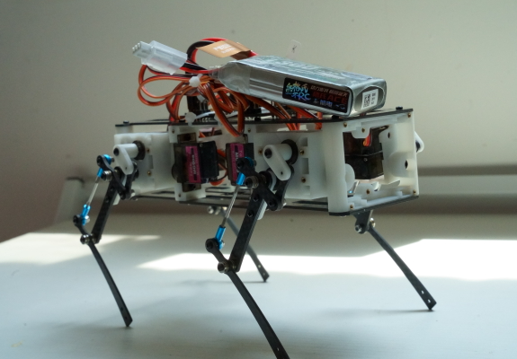

  1. Main controller: HiSilicon Hi3861
  2. 7.4V to 5V: LM1084S-5.0/TR
  3. 5V to 3V3: ME6211
  4. Servo driver: PCA9685, supports up to 16 channels
Mechanical structure
Reference: Mini Pupper
modified the servo arm to adapt to the MG90S, modified the thigh aperture to adapt to the 2.5mm screw hole position

Known issues
  1. The current position of the battery is not very reasonable, and the dog's body structure may be adjusted in the future.
  2. The fixing hole of the PCB board is blocked and needs to be adjusted.
  3. The power supply generates a lot of heat. Consider using DC-DC to replace the LDO in the future.
Functions to be developed
  1. Add front screen. to display some basic information and expressions
