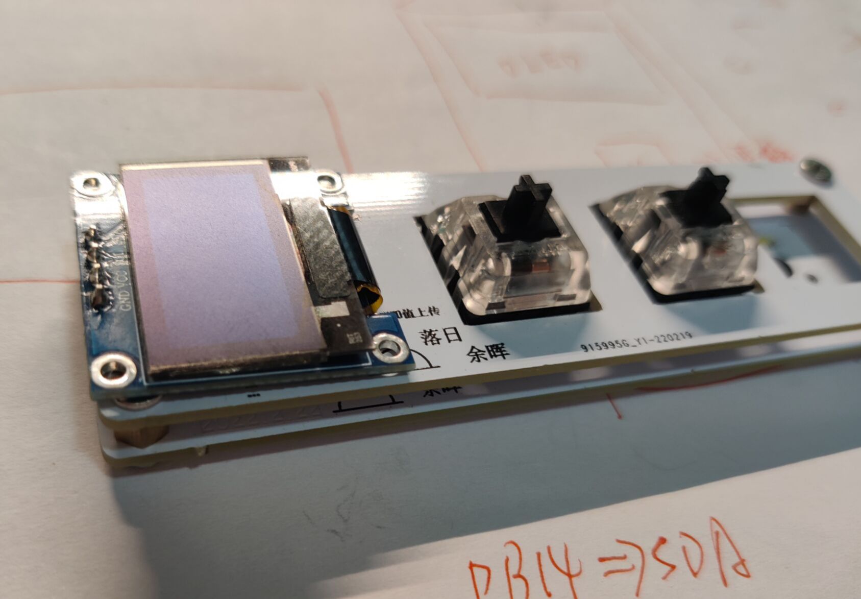

The first version is still in the testing stage, mainly testing the power supply issue. Since the battery was added, I randomly found a power supply charging chip in the Lichuang open source project and sewed it into my own project, so the charging safety remains to be seen.
However, I have tested it before and it seems that there is no problem. However, I found that the wiring in the previous schematic diagram seems to be a little different from the official one, but the battery charging is still no problem.
If you have concerns, you may consider not adding lithium batteries to avoid safety accidents. For this reason, I specially separated the power charging circuit and the stm32 core on two boards. The following figure will introduce it in detail.
Note: The pcb is divided into upper and lower boards, which need to be printed separately. Piecing them together is considered a puzzle. A bottom board may be added later to protect the battery.

Then the appearance is inspired by the small keyboard that has been open sourced before, mainly because it is compact and easy to carry.
The obscene picture is as follows , and the effect picture is as follows:
The board is divided into upper and lower boards. The lower layer is the main core board, and the upper layer is the lithium battery charging module. You need to consider whether you need batteries. If necessary, just connect the upper and lower layers with feet.
It uses two mechanical keyboard key switches, which feels better hahaha. One is reset and the other is jump.

Program programming:
Burn using mcuisp
1. Set BOOT 0 to 1
2. Press the reset button
3. Program programming
as the picture shows
