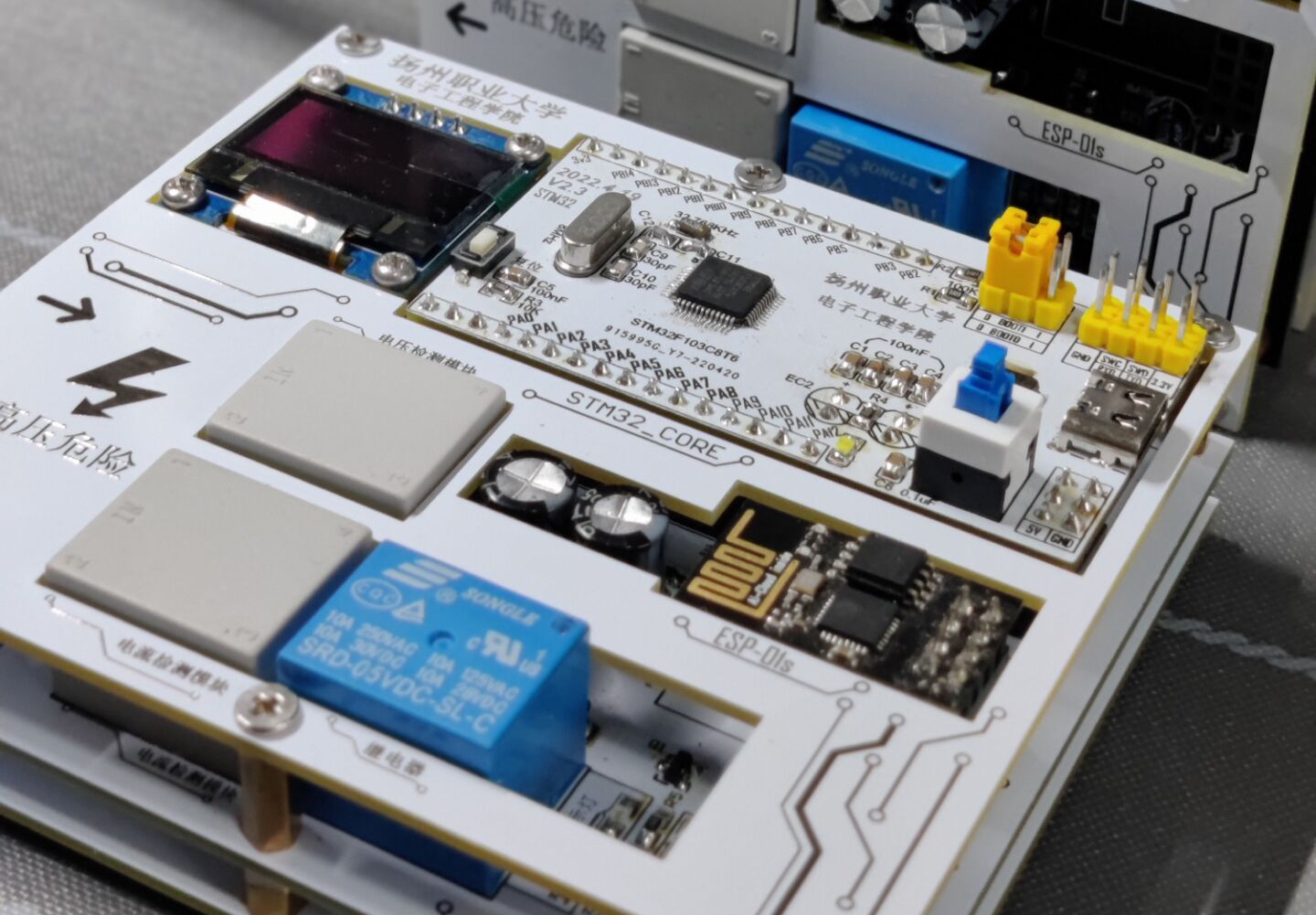

The equipment is divided into two parts. The first part is the stm32 development board, and the second part is the AC voltage and current detection module.
(Subsequent versions may be integrated, directly welding the chips together and removing the development board) Completed

Good news: The V4 version has been integrated and there is no need for additional stm32 development board welding.
The next version is expected to only have minor changes to the hardware, and no new features will be added to the project functions.
Not necessarily, the ec11 encoder may be added and the menu function may be added.
Hardware version update:
V1-2021.12
Modular for easy testing
V2-2022.1
Each module is further integrated into one
V3.3-2022.3.2
Optimize the layout and increase the width of communication lines
New:
1) 0.96-inch OLED
V4-2022.7.19 (Demo)
Please note that the V4 version should not be boarded yet. There is a serious problem that will be fixed in the V4.1 version. The 220v~5v power module has no slots
New:
1) The 220v to 5v module can be plugged in and used without additional type-c power supply.
2) RGB (pseudo) lighting effect (effect to be tested)
3) Figure 8 plug
4) AC power switch
5) 4 expansion holes to facilitate subsequent testing of new functions. (Basically useless, please ignore haha)
Update on progress, almost completed. I went drinking in the evening, and I will continue painting tomorrow (gu gu gu) and I just need to lay the copper.
The V4-Demo version has been uploaded, thank you all for your support!
Demo-V4.1-2022-7-29(uploaded)
Optimize AC line width
Change the pseudo RGBled package (soldering found that the pad is too small and not easy to solder)'
New:
1) Ceramic LED
Fix the packaging problem of 220~5v power module (fix the problem of two long holes not being cut out)
There are insufficient materials and other problems need to be discovered. You are welcome to point them out in the comment area. Thank you very much!

In the picture, the white version is V4.2
1. stm32 development board, powered by type-c interface (v4 version has been integrated, no need to build stm32 development board)
Development board project link:
https://oshwhub.com/Qusenberg/STM32F103C8T6kai-fa-ban
Introduction to program downloading and burning:
The development board supports two interfaces: a download interface and a serial port.
1. SWD program download and debugging interface to facilitate program downloading (self-prepared ST-LINK V2 emulator)
2. Serial port interface to facilitate serial port debugging and program downloading (self-prepared USB to TTL module)
3. Lead to 5V power supply (type-c voltage Straight out) (220V to DC5v module may be added in the future)
2. AC voltage and current detection part
AC voltage transformer TV1005M-1M (available from a few yuan to a dozen yuan)
AC current transformer TA1005M-1M
The relay is Songle's 5V relay
The WiFi module is ESP-01/01S
