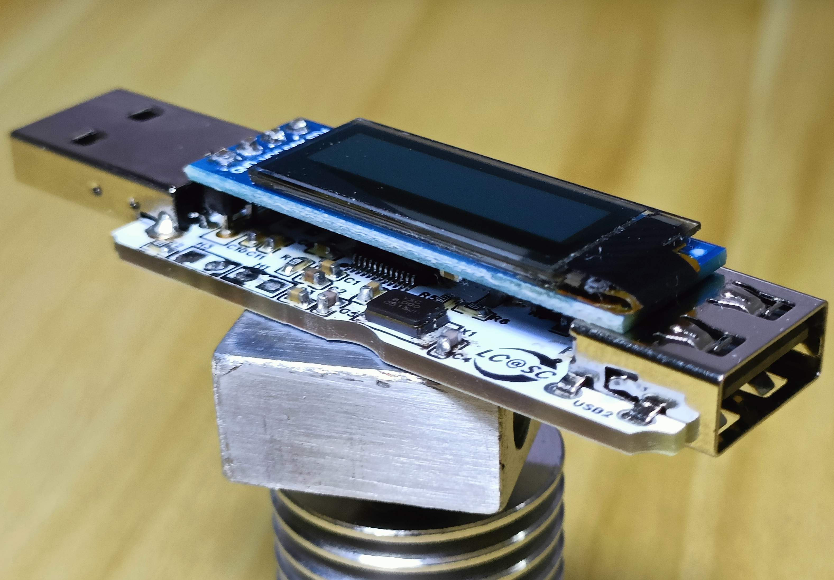

USB ammeter, used to detect real-time voltage, current, power consumption, applicable voltage: 5V USB data pin is not connected to avoid triggering fast charging to open high voltage burn detection table...

USB ammeter based on N32G430C8L7+INA199, with an accuracy of 1%.
