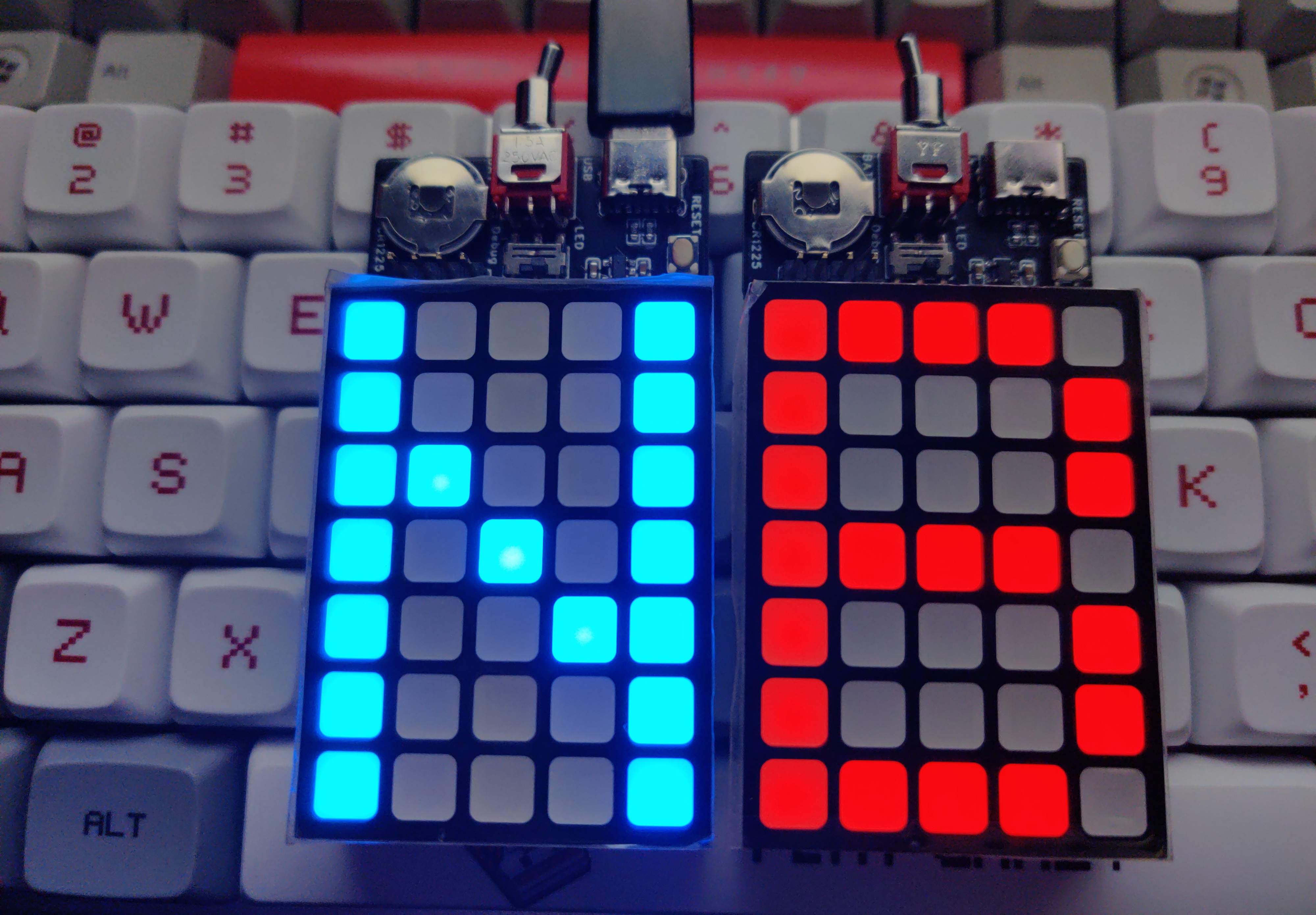

The design of this board is inspired by the official demo of the LPC8N04 official development board (LPC8N04 Development Board for LPC8N04 MCU). The main changes are as follows:
The board is redesigned into a business card shape, divided into two sub-boards, NFC and debugging, of which the debugging sub-board can be removed when not in use.
For the convenience of wiring, the pins of the LEDs are re-modified, but it does not affect the function of the demo (the source code needs to be modified and the firmware recompiled).
The official design uses 35 LEDs to form a dot matrix. Here I directly use a large area of ​​5x7 LED dot matrix (usually used in elevators) for better display effect.
The LED matrix uses a replaceable design, leaving space for the use of crown springs or claw springs, and of course it can also be directly welded.
The multi-power supply design supports three power supply methods: USB, button battery and wireless power supply, which can be switched by a button switch.

Demonstration Video
The following two videos demonstrate the use of the demo, among which:
The first video demonstrates the display effect of the red and blue LED dot matrix, where the red LED dot matrix is ​​powered by a CR1225 button battery and the blue LED dot matrix is ​​powered by a USB-C interface.
The second video demonstrates NFC wireless power supply, which only uses the power provided by the mobile phone NFC to light up the LED dot matrix (the display effect is better in a dark environment).
