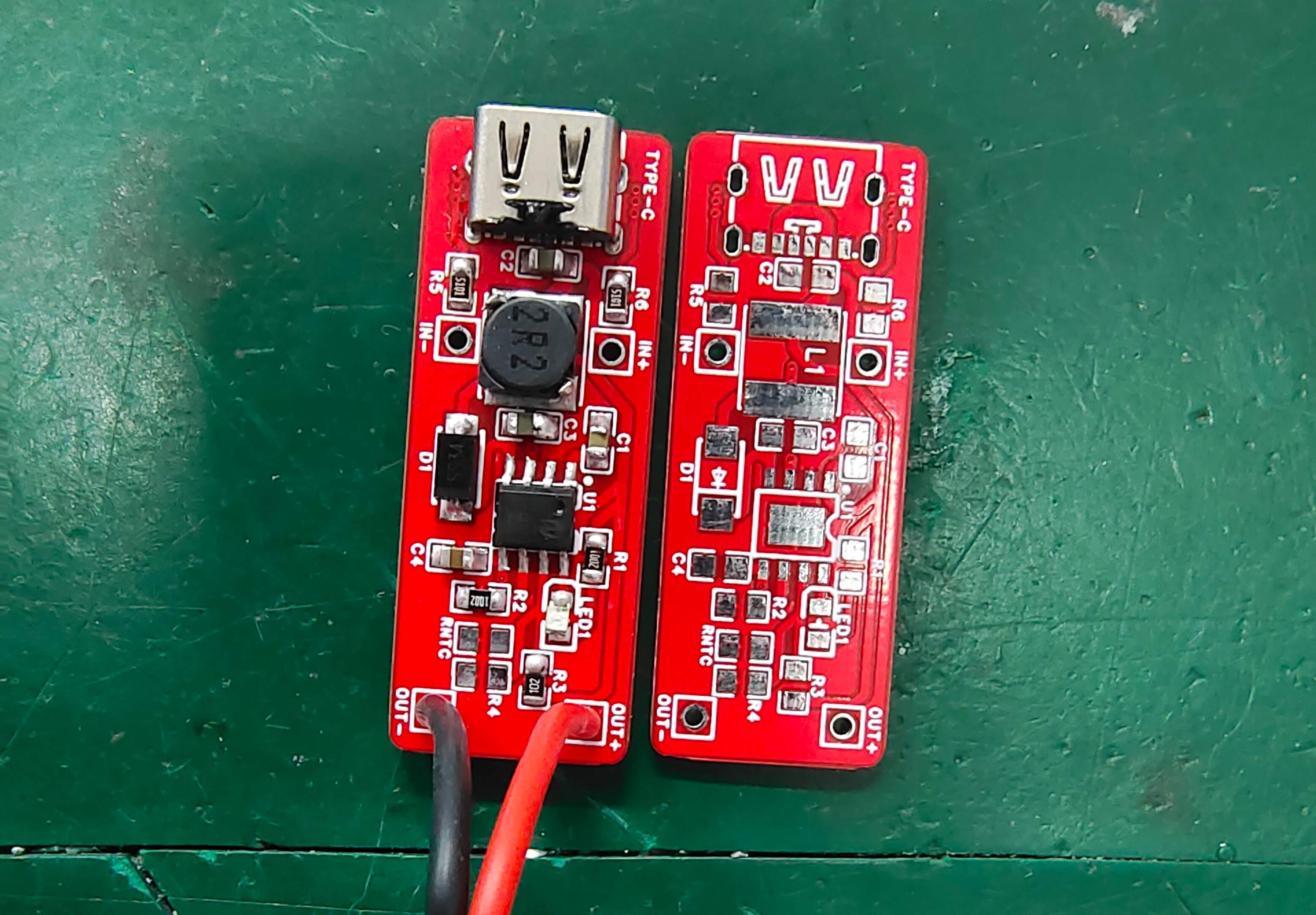

[5V input] Boost charging, can charge two series lithium batteries (8.4V) circuit
characteristic:
    USB 5V input asynchronous switch boost charging.
    The operating voltage is 3.5~18V, the internal integrated high-voltage transistor has a maximum charging current of 1.5A, and the charging current is adjustable by an external resistor.
    NTC function.
    Boost charging efficiency is 90%.
    The automatic power balancing function can automatically adjust the input current for charging series batteries separately, matching all adapters.
    Supports LED charging status indication.
    Built-in power MOS.
    500KHz switching frequency, can support 2.2uH inductor.
    Output overvoltage, short circuit protection.
    Input undervoltage and overvoltage protection .
    IC over temperature protection.
    ESD 4K

BOM table
