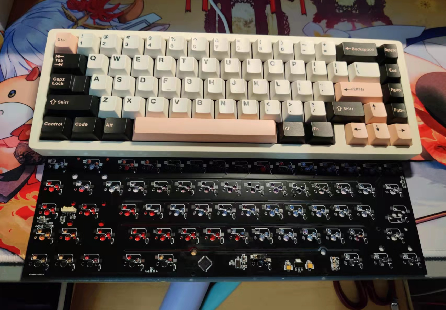

Support pcb satellite axis
Using qmk firmware, supports via instant key change
Personally, I think the 1.2 slotted PCB is too soft, and I recommend using 1.6
The route after the two-hour run is a bit messy. Those who are capable can walk it by themselves.
The decoupling circuit on the sample board was placed too far apart. This has been corrected. The following is the actual picture.cVzriakYCy2XtPVzd8zaSq2tTzERopFUfJhuUqU2.jpegEDkf5S1gXI51ZsyIUyl1hC2xIy0CvqAE9mDeWA6B.jpeg9ZENExDB7G6iJWDvGfjhzOT4ROpD7RJEBtlSusqA.jpegyt0vl1xyLYKjp7774oOQlK6e6cL06ITaKrdJt51u.jpeg
