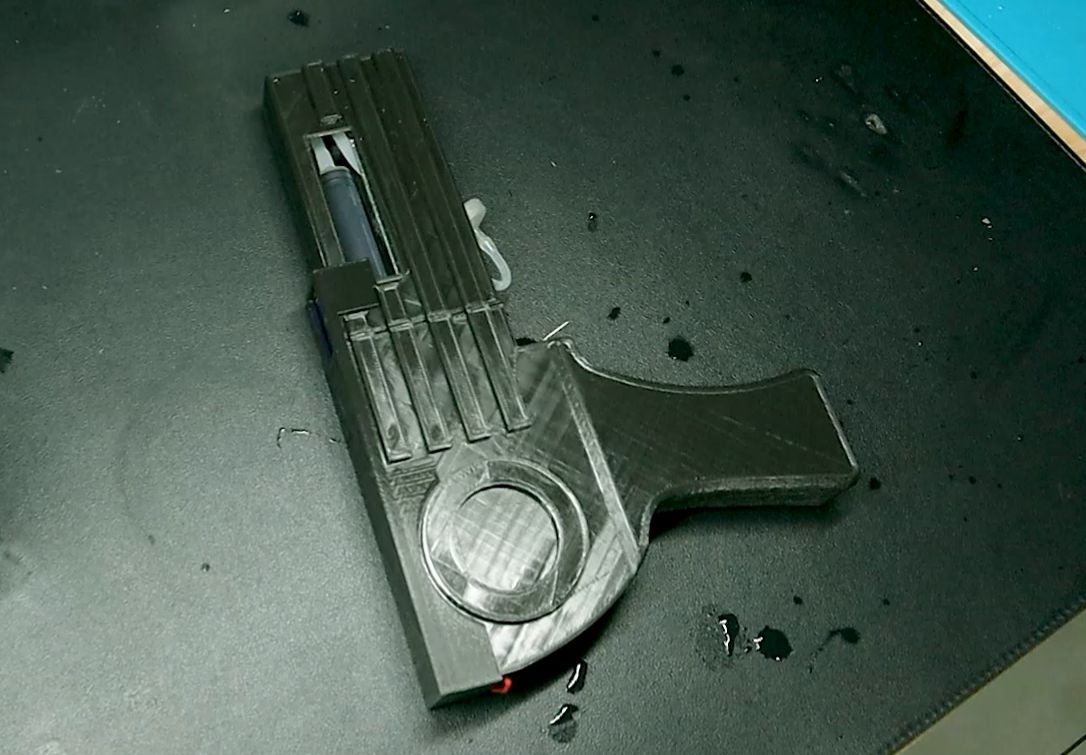

When I was shopping on Taobao, I saw the water mist pump disassembly accessories and found that it was a good thing that can be used to modify the water gun.
The main structure is to add a pipe in front of the water mist pump as a water storage space for launching. The water can be sprayed out using the pressure of the water mist pump.
A syringe was modified with a screw motor. A 10ml syringe was added to a 100mm N20 screw motor with a speed of 600, and a 75mm sliding potentiometer was added to form a quantitatively controllable syringe.
The principle of the program is very simple. After pressing the trigger - the screw motor advances - the water pump motor runs.
The program was later modified: press the trigger - the water pump motor starts firing - and finally the screw motor withdraws to prepare for the next launch.
The display can directly feedback the remaining water volume in the water tank (syringe)
