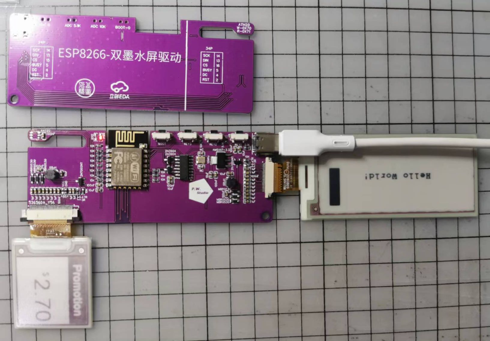

ESP8266 Blackwater Dual Screen Driver Board
ESP8266 Ink screen dual screen driver board. Verified.
Refer to https://www.waveshare.net/wiki/E-Paper_ESP8266_Driver_Board#ESP8266.E8.B5.84.E6.96.99
The function pin IO signal has been written on the silk screen.
Arduino serial port automatically burns. Added a temperature and humidity chip that multiplexes I2C.
There is no problem driving one side of the board. But driving two boards at the same time seems a bit ineffective.
The reason is unknown at the moment.
