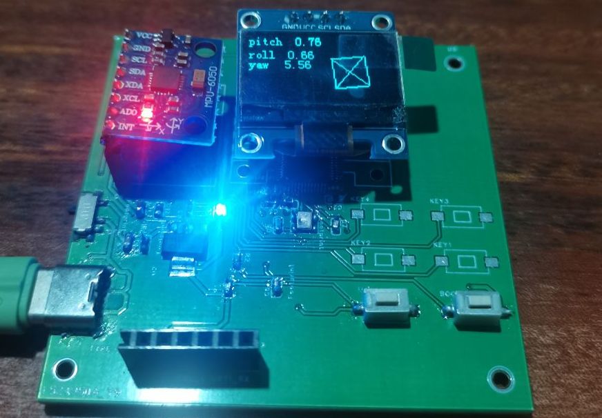

VI. Physical Demonstration
6.1
After power-on and power-on reset, the module posture is horizontal and static.
The host computer displays the screen when static.
6.2 The module is tilted 45 degrees to the right
. The OLED display is tilted 45 degrees to the right.
The upper computer display is tilted 45 degrees to the right.
6.3 The module is tilted
35 degrees to the left and 21 degrees downward. The OLED display is tilted 35 degrees to the left and 21 degrees downward.
The upper computer display is tilted 35 degrees to the left and 21 degrees downward.
Notes
After reset, it usually takes 3-4 seconds for the OLED to display normally. This is mainly because there is a self-calibration process of MPU6050 during the DMP initialization process. Therefore, for the user's experience, you can consider displaying "calibrating" on the OLED as a prompt;
after reset, the module must be placed flat and the sensor calibration is completed before moving the module;
users can modify the Set_Slaver_Address() function to configure PB2 to pull up and down to modify the MPU6050 address. In the code, PB2 is pulled down, so the address of MPU6050 is 0x68.
After a period of time, the Euler angle Yaw has obvious drift. This is because the magnetic sensor is not added for algorithm fusion, which is a normal phenomenon. Those who are interested can study how to solve the drift problem.
