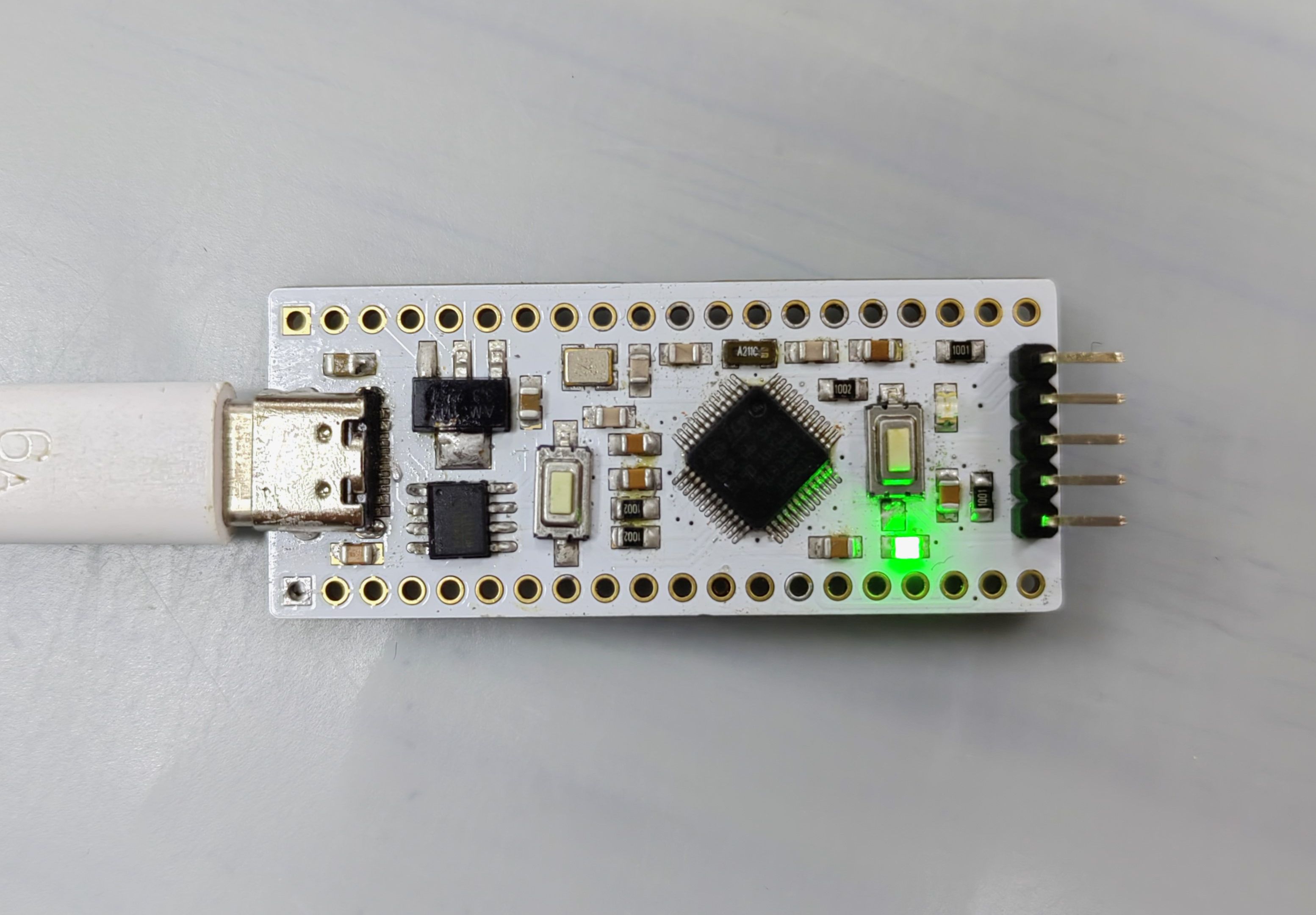

## The board has arrived. I will record the soldering process.
This is the second time I solder SMT. I hope it won't overturn
! [IMG_20230428_175550.jpg]
I don't know what went wrong. My color silk screen is gone (QAQ). Only the white and gold PCB is left (but don't say it, it looks good this way)
(Additional: I have reported it to Jiali Chuang and solved it~)
! [IMG_20230428_175433.jpg]
Apply solder paste and paste the components (there is no silk screen, so I have to place the components according to the project file)
! [IMG_20230428_175947.jpg] Heat it up on the heating table first. After that, there are some extra solder balls and connected pins. Use a soldering iron to repair them
! [IMG_20230428_182520.jpg] After the repair, it is as shown in the picture~
Addition! Remember to solder the reinforcement points of the Type-C mother seat!
![markIMG_20230428_183615.jpg]
Otherwise, you will pull off the mother socket and the wire together like me... (・ω・`ll)
After some mending, it is finally done
![IMG_20230428_183615.jpg] ![IMG_20230428_183625.jpg] The power-on test is successful~
