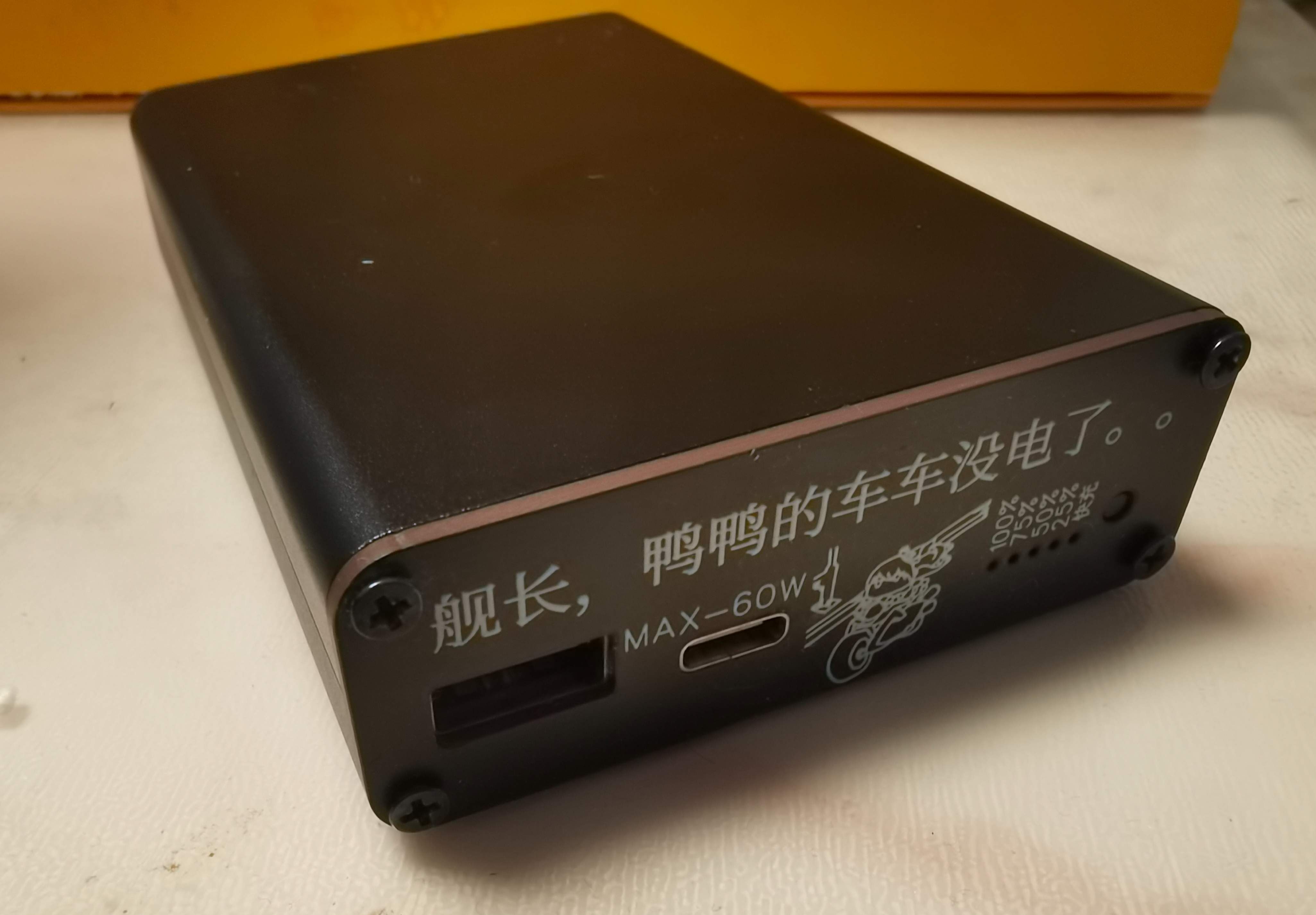

A 3-string 21700 single C-port mobile power supply solution designed based on ip2368-cout, supports up to 20v5a. 100 watts.
It is fully compatible with the size and shell of another open source project of mine, ip5389-3s. In comparison, the advantages are greater power and lower cost. The disadvantage is that there is no A port and buttons. You can use the 5389-3s project when punching the PCB of the shell. In the panel drawing, you can use it by deleting the hole for the A port and the button.
The outer casing is an aluminum profile with a size of 71*25.5mm. You can definitely find it on Taobao and the price is not expensive.
Remember to add a lithium battery protection plate to the battery pack, and remember to use high-rate batteries such as Lishen 21700la. Otherwise, it may generate serious heat when charging and discharging at 100 watts.
