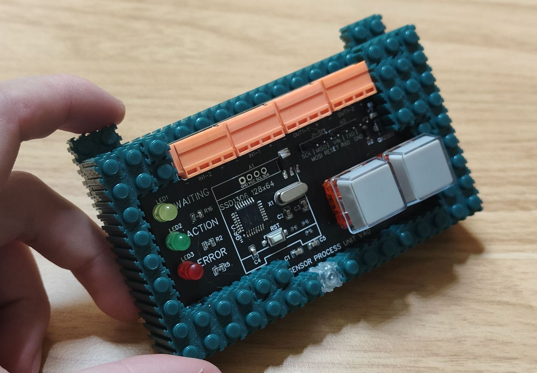

Description of the project
This design is mainly for easy programming and quick application at a limited cost. I deliberately used Atmega48, which is currently cheap and easy to obtain, with a minimum of only 6 yuan (excluding postage) and high thrust ( 10ma per pin) and still 5V.
The key is to use Arduino IDE, but there is no Bootloader at the moment, so you need a USBASP or programmer. I use TH866A, which is quite easy to use.
For design reasons, I would like to suggest the configuration of sensors and actuators. What are actuators, such as relays, single-channel MOS tubes, etc. Therefore, the PCB is equipped with a large interface, which can be plugged and plugged in and out. The connection is strong and I like it.
It is highly recommended to use Atmega8.
Test method

In terms of design considerations, the three lights function as
Yellow waiting: sensing
Green activation: The set value or target is sensed and the action has been triggered.
Red error: Some problems, such as sensor value errors
The function of the two buttons is very clear, which is to provide a good feel and be easy to install, so five JIO mechanical keyboard switches are used.
This model tried its best to reduce the budget on circuit components, so it did not set up the common serial port to USB, but I configured a set of lithium battery boost circuit, which can stably output 5V to Atmega48, but the input voltage cannot exceed 5V, otherwise no matter how much input Just output as much as you want.
Because there is no Bootloader available, there is no need to lead out pins such as DTR, so they are omitted on the board.
It should be noted that the connected battery must have a protection board. There is no charging circuit designed. You can choose a common charging module and connect it in parallel to the battery input terminal.
Note: MiniCore library needs to be installed, which has been marked on the schematic diagram.
