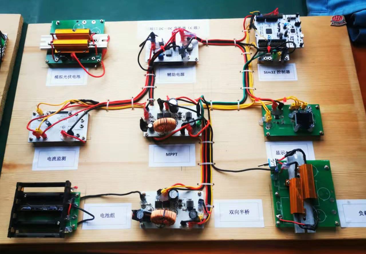

The bidirectional half-bridge circuit is used as the main topology, and STM32G071 is used as the control core to coordinate each module to achieve the task requirements. The circuit is divided into main circuit topology module, control module, PWM control signal drive module, auxiliary power module, and voltage and current sampling module. The main circuit topology module uses a dual half-bridge circuit; the control module uses the PWM output port of STM32G071 to generate PWM signals, collects voltage and current signals through ADS1115, and performs proportional and integral adjustment by the program to perform reliable closed-loop control. Judging from the measurement results, it is completed Understand the basic requirements of the topic and some of the requirements for performance.
1. 1 system solution
STM32G071 is used as the main control of the system, outputs PWM signals, and controls IR2104 to form a half-bridge chopper Boost circuit to achieve maximum power point tracking of the input port. At the same time, STM32G071 controls IR2104 to form a bidirectional half-bridge chopper Buck circuit to stabilize the output voltage. The 30v required by the voltage system changes the Buck circuit duty cycle according to Uo, allowing energy to flow freely in both directions from the output port and energy storage port. The PI proportional integral adjustment is made to the PWM signal according to the feedback signal, thereby achieving the output deviation ΔU1=|U1-0.5×Us|≤0.1v. The picture is a block diagram of the program system.

2.1.5 Half - bridge circuit
The half-bridge circuit is shown in Figure 7. IR2104 is used as the half-bridge driver chip, and the field effect transistor is HY4008 , so a Schottky diode 1N5819 is added . The half-bridge driver IR2104S can obtain sufficient gate voltage through bootstrapping .
Actual picture as shown

2.3 Programming
The program design block diagram is shown in the figure below. The microcontroller measures the output voltage Uo, input voltage Ui and input current Ii, controls the Boost circuit to perform MPPT maximum power tracking, and adjusts the duty cycle of the voltage stabilizing circuit to form a closed loop for proportional and integral control to make the output The voltage Uo is stable at 30V.
The program flow chart of the system is shown in the figure.
The principle of MPPT program is as shown in the figure
This program uses the perturbation and observation method. When the output voltage stabilizes at 30V, the maximum power point tracking (MPPT) slightly changes the reference value of Ui by modifying the switching frequency of the half-bridge. Ui will follow this value. After it stabilizes, if the power increases, it will continue to move in that direction. Change the Ui reference value, otherwise fall back. Repeatedly. See Appendix 2 for the complete procedure.
