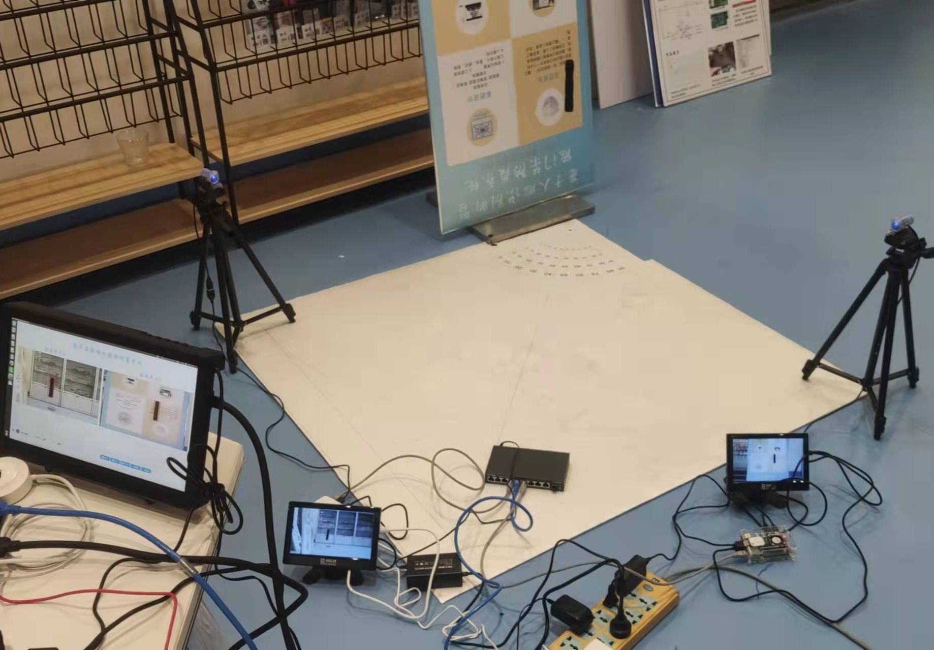

### 5. System hardware
1. Overall system block diagram
The overall system block diagram is shown below, which mainly includes the main control module Raspberry Pi 4B, USB camera, Ethernet switch and display.
![image.png] 2. Terminal node and camera node
The terminal node uses JetSon TX2 as the main control, receives the video stream information of the camera node on the Ethernet physical medium, and automatically measures the length by processing the periodic swing video signal of the laser pointer. l and angle θ.
The camera node is controlled through Raspberry Pi 4B. The USB camera is connected to Raspberry Pi 4B. The monitor is connected to Raspberry Pi 4B to display real-time video. At the same time, Raspberry Pi 4B performs RTSP streaming to realize video data transmission.

### 10. Notes
1. Affected by physical factors such as the rotation of the laser pointer, the laser pointer should be as close to the pendulum as possible when releasing it Movement, the light spot basically remains straight.
2. Note that the IP address of the Raspberry Pi and the master node must correspond to each other~~~~
