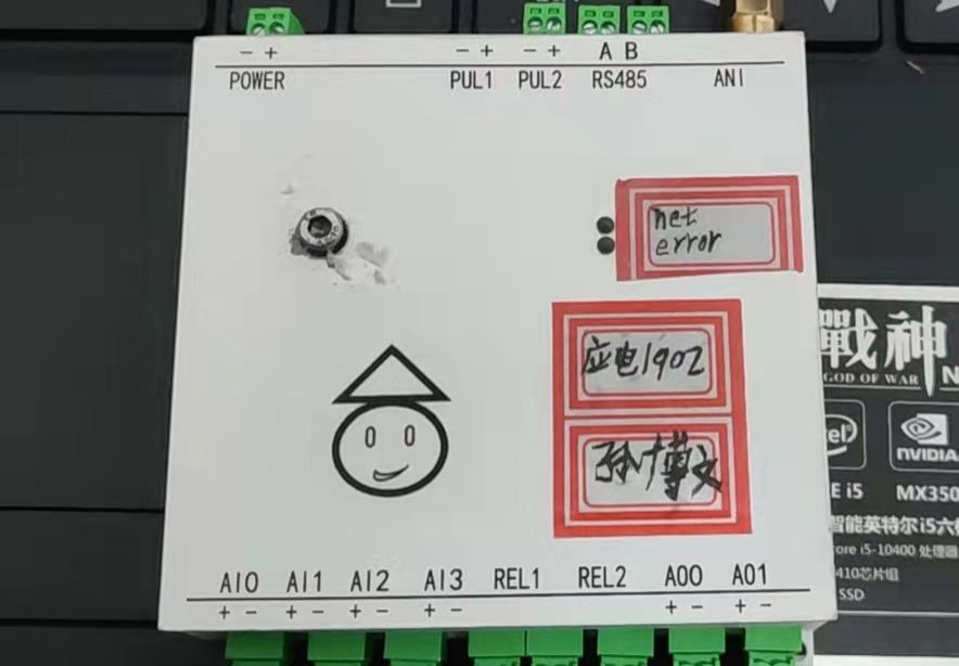

## Schematic design description
The power circuit consists of the power indicator circuit, It consists of lightning protection circuit, short circuit protection circuit, 5V voltage stabilizing circuit and 3.3V voltage stabilizing circuit. Please refer to the schematic diagram for the specific circuit. The minimum system circuit consists of a microcontroller, a reset circuit and a crystal oscillator circuit. Please refer to the schematic diagram for the specific circuit. The analog input circuit consists of a resistor voltage divider circuit, an ESD circuit, and a filter circuit. Please refer to the schematic diagram for the specific circuit. The analog output circuit consists of an optocoupler circuit, PAC chip, PMOS circuit, ESD circuit and filter circuit. Please refer to the schematic diagram for the specific circuit. The digital output circuit (relay) consists of a relay drive circuit and a relay. Please refer to the schematic diagram for the specific circuit. The digital output circuit (transistor) consists of a level conversion circuit and NMOS. Please refer to the schematic diagram for the specific circuit. The RS485 communication circuit consists of the MAX485 chip, transceiver conversion circuit, ESD circuit, and filter circuit. Please refer to the schematic diagram for the specific circuit. The LORA communication circuit consists of a jumper cap and a LOAR module. Please refer to the schematic diagram for the specific circuit.
## PCB design instructions
In terms of PCB layout, attention should be paid to the location of the terminal blocks to facilitate installation. The line width is set according to the current size, usually 1mm flows through 1A current. In order to improve the accuracy of analog quantity collection, high-precision resistors can be selected.
