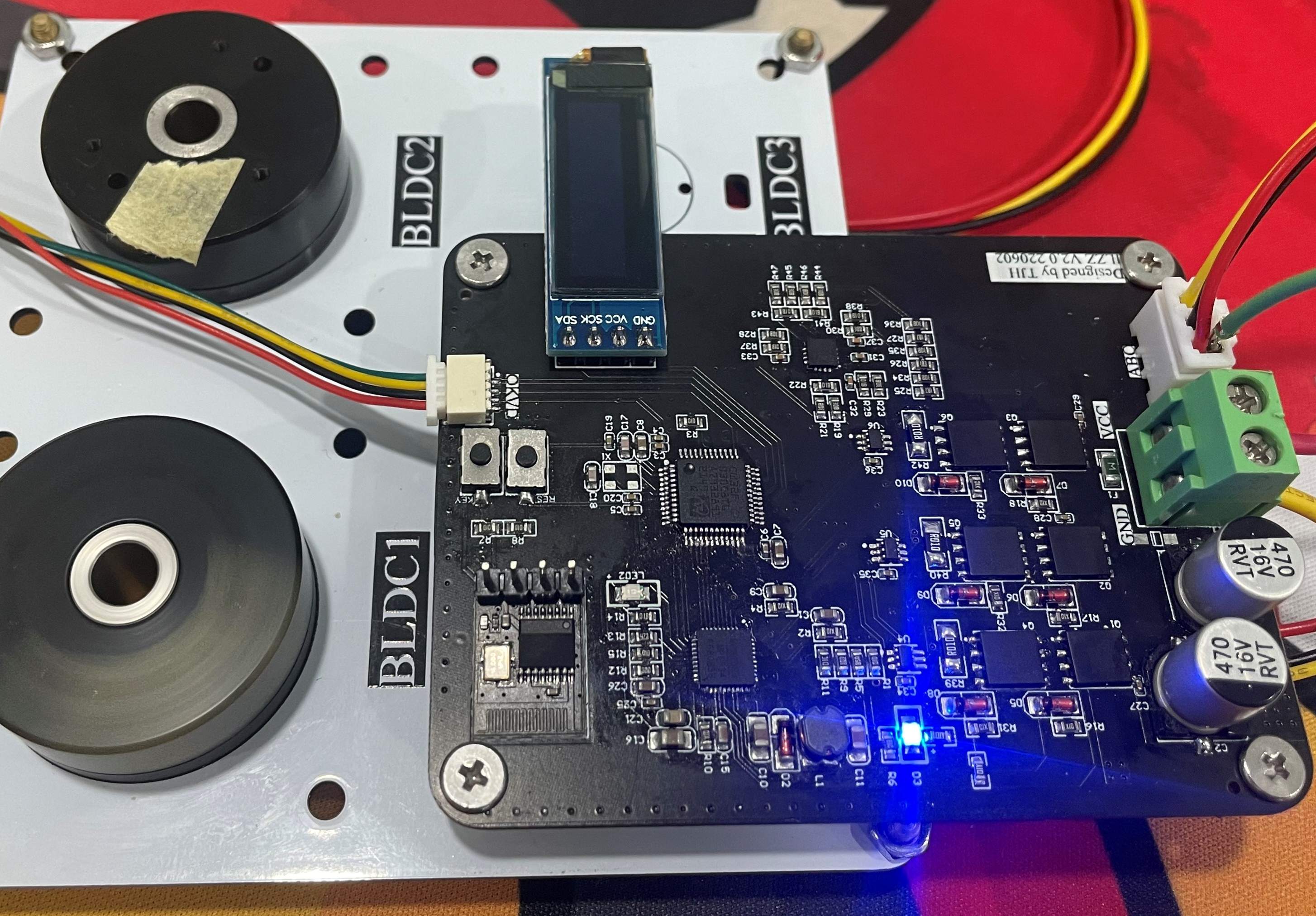

Analysis of the problem of brushless motor driver based on MP6534 front-end driver
. The overall design plan is divided into CW32 minimum system, MP6534 peripheral circuit design, three half-bridge inverters composed of MOS tubes, Bluetooth serial port module, and OLED display module. The design drive current is 8A.

3. CW32 microcontroller minimum system and interface: The peripheral circuit of the
CW32F030 minimum system
chip is designed according to the official case and small blue board. OLED and SWDIO download interfaces are reserved, and a user button is added.
4. Motor drive chip MP6534
The MP6534 chip and its peripheral circuits
can be designed according to the chip manual. The parameters that need to be designed by yourself include the setting of dead time and short-circuit current. Select the resistance values ​​corresponding to the DT and OREF pins respectively. Note that the nSLEEP pin needs to be connected to an external pull-up resistor to 3.3V before the chip can start. I have stepped on a trap here.

5. Three-phase inverter circuit The MOS
of the three-phase inverter circuit
is SM66406D1RL, 40V@30A, and the on-resistance is less than 12 milliohms. After the board was finalized, a better MOS was discovered, but it was too late. Here we recommend two brands: Wuxi New Clean Energy and Weishuo.
The G pole of the MOS is connected in series with a 10-ohm resistor to suppress oscillation caused by the wiring inductance. The diode connected in parallel with this resistor is used to speed up the turn-off time. (The chip manual has detailed instructions and experimental diagrams, the following is excerpted from the chip manual)
G pole has no series resistance (100nS/div.)
G pole has a 100 ohm resistor in series (200nS/div)
G pole has a 100 ohm resistor in series and a 1N4148 diode in parallel (200nS/div. )
Through comparison, it can be concluded that the turn-on time of MOS with and without series resistance will be prolonged, but there is almost no oscillation during the turn-on process of MOS. After connecting the diode in parallel, the turn-off time is greatly shortened (yellow line). Reducing the switching time is conducive to reducing the switching time. losses and improve efficiency.
The lower end of the ABC three-phase bridge arm is connected in series with a 10 milliohm resistor for current sampling.
Constructing a virtual neutral point
6. Terminal voltage and phase current acquisition
Here a universal operational amplifier is used to construct the acquisition operator. The principle is shown in Figure 7.24 below: The hardware implementation of terminal voltage acquisition
U5 is a 4-way universal operational amplifier, model: LM324QT, package Size: VQFN-16_L3.0-W3.0-P0.50-TL-EP is the smallest 4-way op amp I can find in Lichuang Mall. According to the knowledge of analog electricity, the addition and subtraction circuit is connected according to Equation 7.2.
Similarly, there is current sampling: the current and voltage values ​​calculated by the current sampling op amp through the operational amplifier are sent to the CW32 ADC for sampling. 7.LED indicator light and Bluetooth serial port module. The Bluetooth serial port module and LED indicator Bluetooth serial port were purchased from Taobao and are very cheap. Overview of the schematic diagram This completes the explanation of the schematic diagram. PCB Design Instructions PCB TOP Overview PCB BOTTOM Overview PCB 3D Preview I have only been studying PCB design for 4 months. There are definitely many shortcomings. Please criticize and correct me. The software description originally wanted to control FOC, but as of June 14, it has not yet been implemented. Currently, it can realize non-sensory open-loop rotation and button speed adjustment, and other functions are to be developed. Physical display description The attached content of the PCB physical diagram is a document for study and reference of this work. Acknowledgments Thanks to Piggy. Thanks to Jialichuang and Wuhan Xinyuan Company for organizing the training camp, which allows novices who are new to hardware to have projects to do, materials to learn, and coupons to receive. Thanks to Jialichuang SMT, it feels so good not to have to manually apply the patch. Thanks to Chuangxin Workshop for sponsoring PWLink. Thanks Orange.
