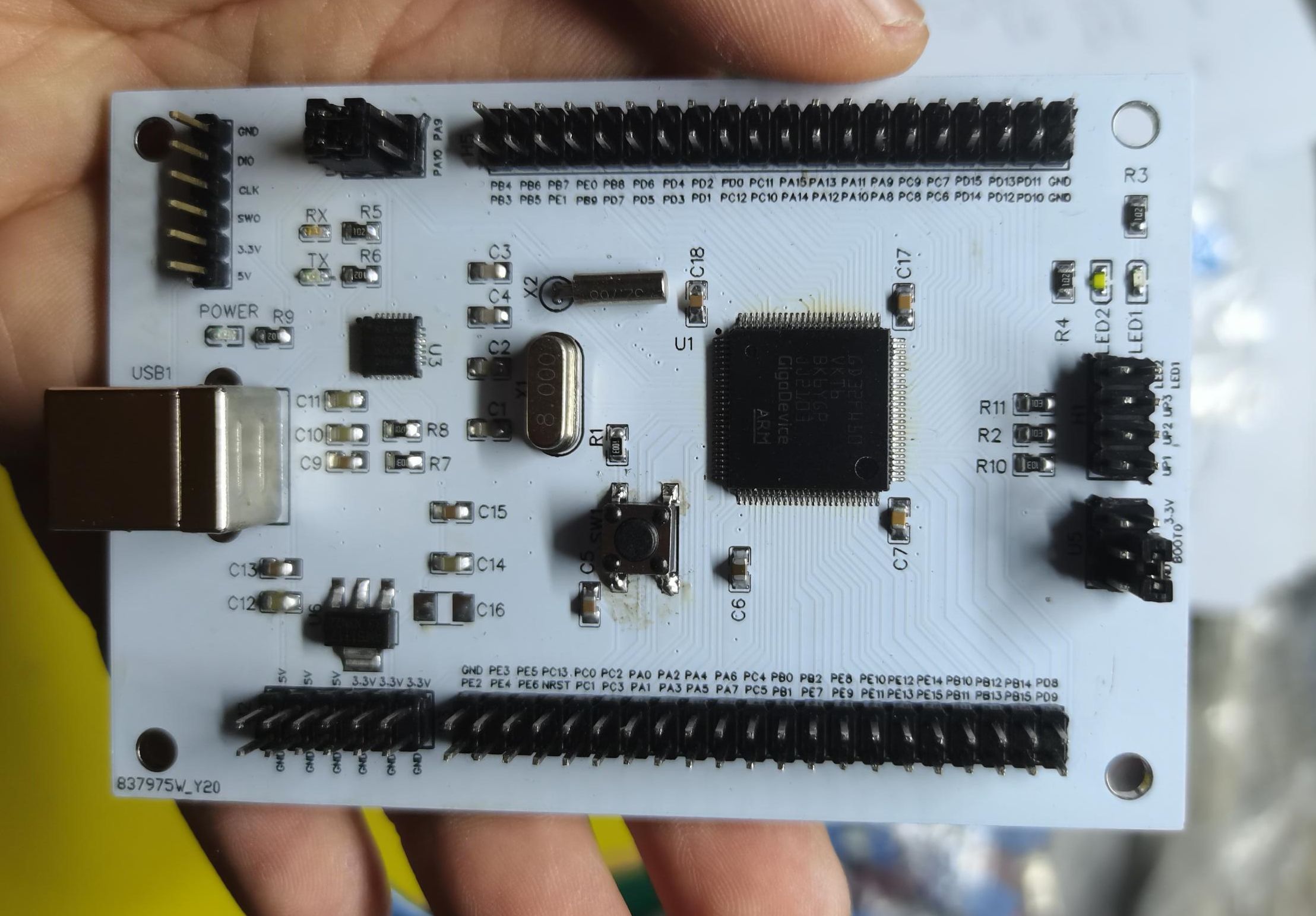

GD32F450V minimum system board
I still remember when I first used GD, the GD development board was not all pin-out. Some pins were connected to the USB chip, so I always had to look at the schematic diagram and change the wiring. Very annoying.
All the pins of this board are lead out, and serial port 1 is connected to type-b using a jumper cap.
The LED is reserved for pin headers, so that any pin can be used to control the LED using Dupont wire.
The board is designed with a pull-up resistor, and any pin can be connected to a pull-up resistor using a DuPont wire.
Only the cleanest board is the best to use.
At the same time, because I had some leftover chips, I put them on boards and sold them to recover the cost (these chips were used for a project during the epidemic, and they were so expensive when I bought them, I cried). Search "I am Hadashi" on Xianyu. User purchases.
