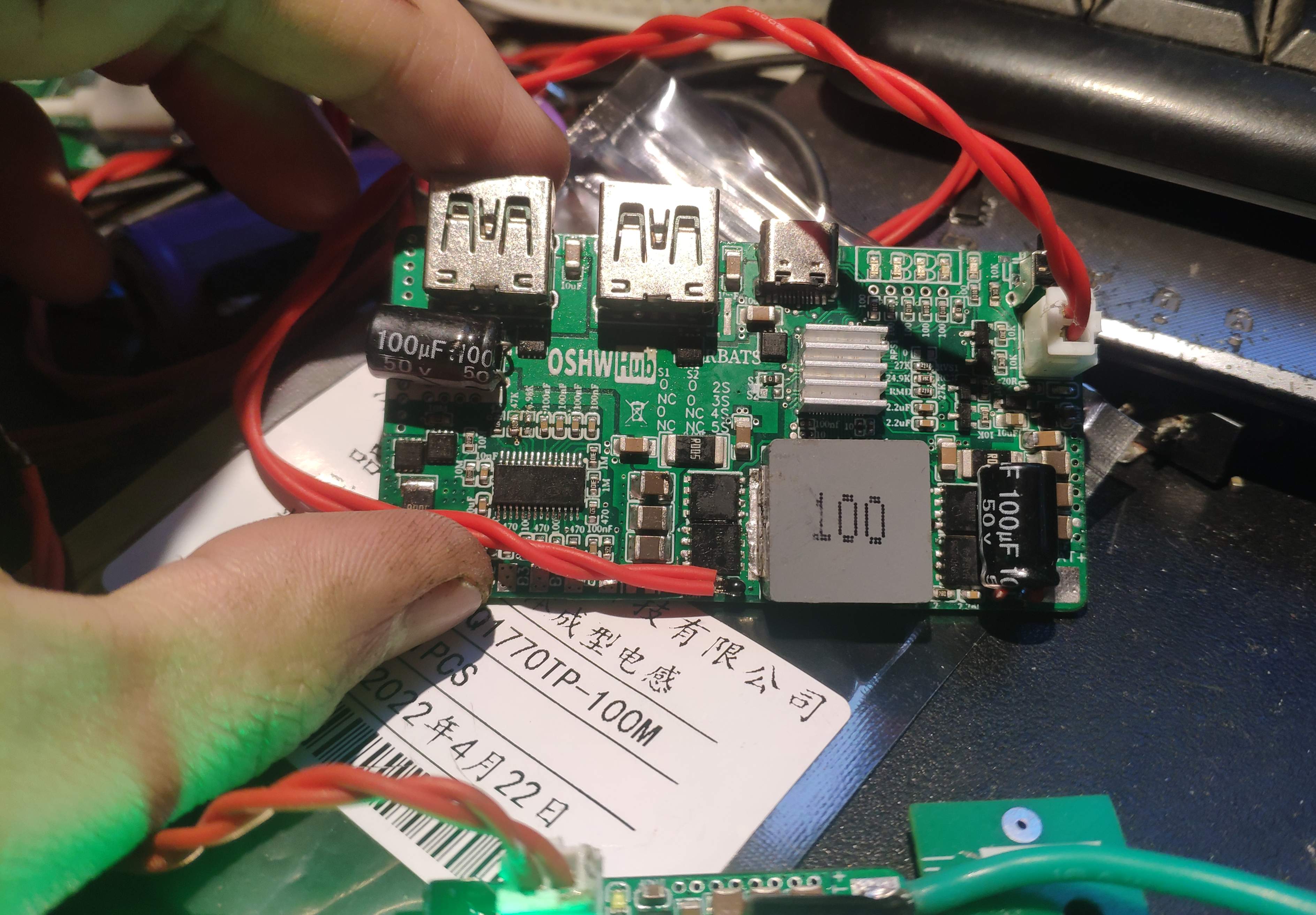

Support multiple USB ports at the same time
2 USB A port output
1 USB C port input/output
1 USB B port or Lightning port input or C port input/output
Fast charging specifications
Any port is supported Fast charging
Integrated QC2.0/QC3.0/QC3+ output fast charging protocol
Integrated FCP input/output fast charging protocol
Integrated AFC input/output fast charging protocol
Integrated SCP input/output fast charging protocol
Integrated VOOC input/output Fast charging protocol
Integrated DRP try.SRC protocol, PD3.0 input/output fast charging
Compatible with BC1.2, Apple mobile phone fast charging
Integrated USB Power Delivery (PD2.0/PD3.0) protocol
Supports PD2.0 bidirectional Input/output protocol
Support PD3.0 bidirectional input/output, PPS output protocol
Support 5V, 9V, 12V, 15V, 20V voltage range input
Support 5V, 9V, 12V, 15V, 20V voltage range output
Support PPS 20mV/step output voltage range
Integrated hardware bidirectional mark codec (BMC) protocol
Integrated physical layer protocol (PHY)
Integrated hardware CRC
Support Hard Reset
Integrated recognition and support for E-MARK cables
Integrated power Control
Integrated bidirectional BUCK-BOOST power NMOS driver
Integrated charge-pump control external path NMOS
Charging specifications
Battery end charging current up to 5A
Adaptive charging current adjustment
Supports 4.1V, 4.15V, 4.2 V, 4.3V, 4.35V, 4.4V
battery
Supports 2/3/4/5 cells in series
Discharge specifications
Maximum output power 100W
Synchronous switch discharge 5V 2A Efficiency over 97%
Supports line compensation
Battery display
Built-in 14bit ADC and fuel gauge
Supports 4 LED power display
Supports 88, 188 and other digital tube power display
Supports external PIN to select digital tube or LED light for power display
Self-learning power meter, more power display Uniform
Initial battery capacity PIN optional configuration
Other functions
Automatically detect insertion and removal of mobile phone
Fast charging status indication
Support battery temperature detection
Intelligent identification of load, automatically enter standby under light load
Multiple protections, high reliability
Input overvoltage, undervoltage protection
Output overcurrent, overvoltage, short circuit protection
Battery overcharge, overdischarge, overcurrent protection
IC overtemperature protection
Charge and discharge battery temperature NTC protection
ESD 4KV, input (including CC/DP/DM pin) withstand voltage 30V
Minimalist BOM
Built-in switching power MOS driver
Single inductor realizes charging and discharging functions
The device is limited to 8 meters and the measured functions of each port are OK
