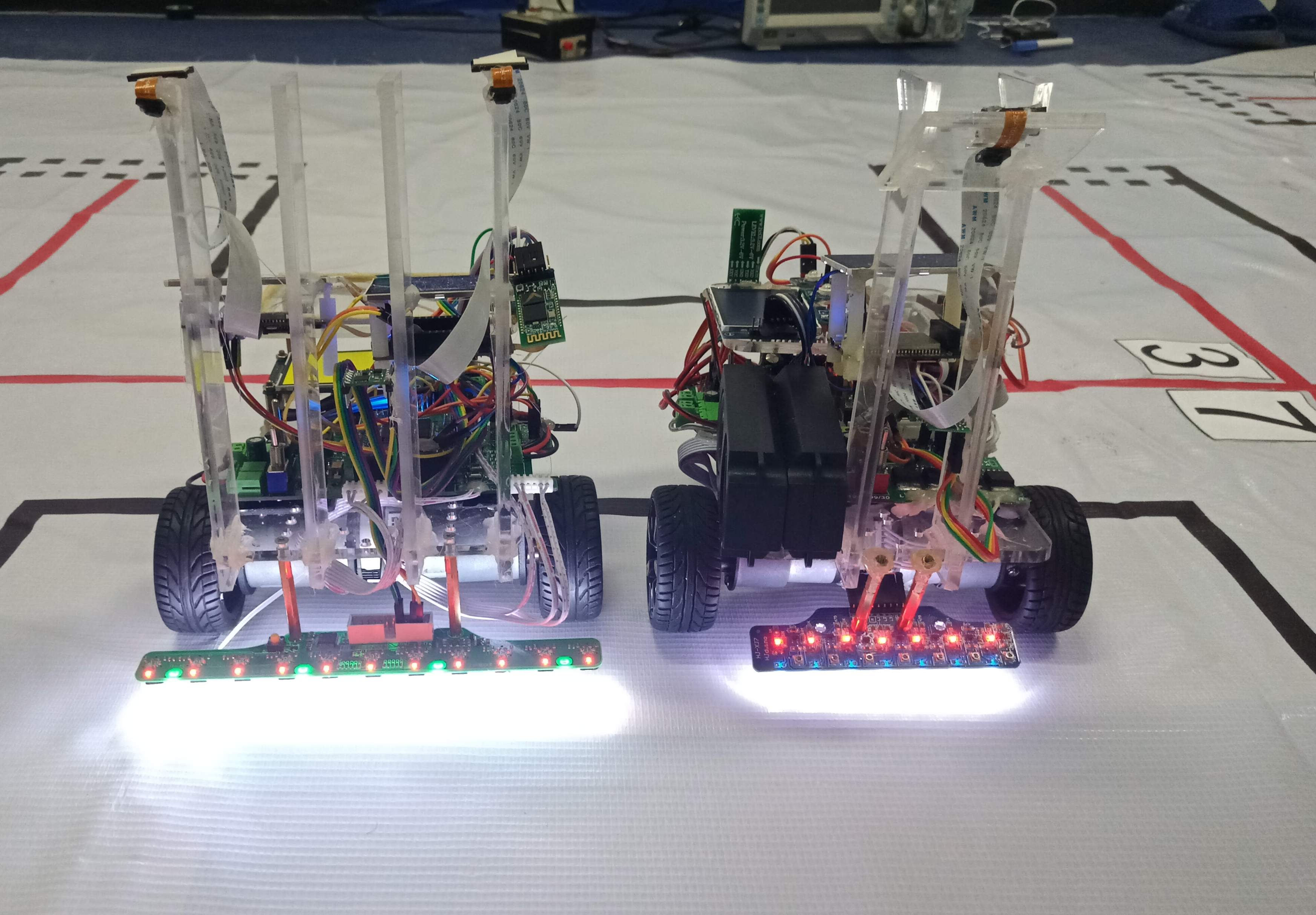

6. Physical display
BRqTwOx6Gk0WsNLAcnOzFHSG4oOtmiHnafUFH6Lh.jpeggWIoRzFX1XKYl1sPoImsRJAVAvpGn5GGwLefmFc5.jpeg
7.Assembly of works
Car bottom plate (one motor hole is missing, it does not affect it)
The top plate and lens fixing parts are laser cut from 5mm acrylic.
The battery uses two 18650 cells. The battery box is fixed between the bottom motor and the universal wheel with hot melt glue, and two boards are fixed on the board.
Note that the motor must use a high line speed!
