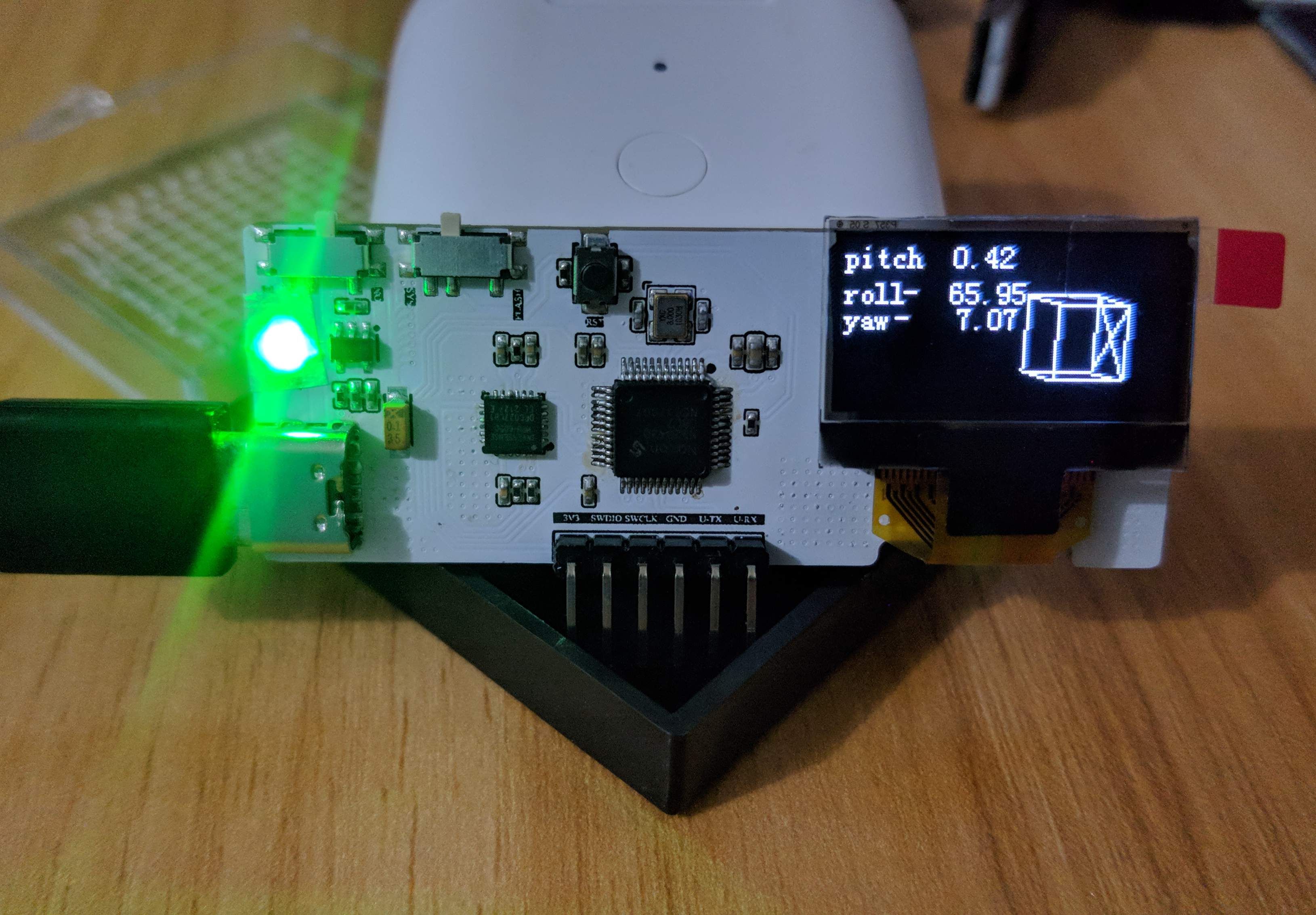

8. The actual product has been soldered and verified, but the OLED cannot be correctly attached to the back of the board due to the reverse order of the FPC pins QAQ (see the actual product picture below for details). It has been corrected and re-boarded for verification.
9. Be sure to put it horizontally after turning on the power, then press the reset button, and wait for about 2 seconds to see the Euler angle information in the OLED.

Actual picture:
![650f472490fce8984f2e72691d22c9e.jpg] ![18bbbf9c4a3b1726249f26b70701ea2.jpg] ![df6348916424cd162c5f4ca7fd656fe.jpg]
