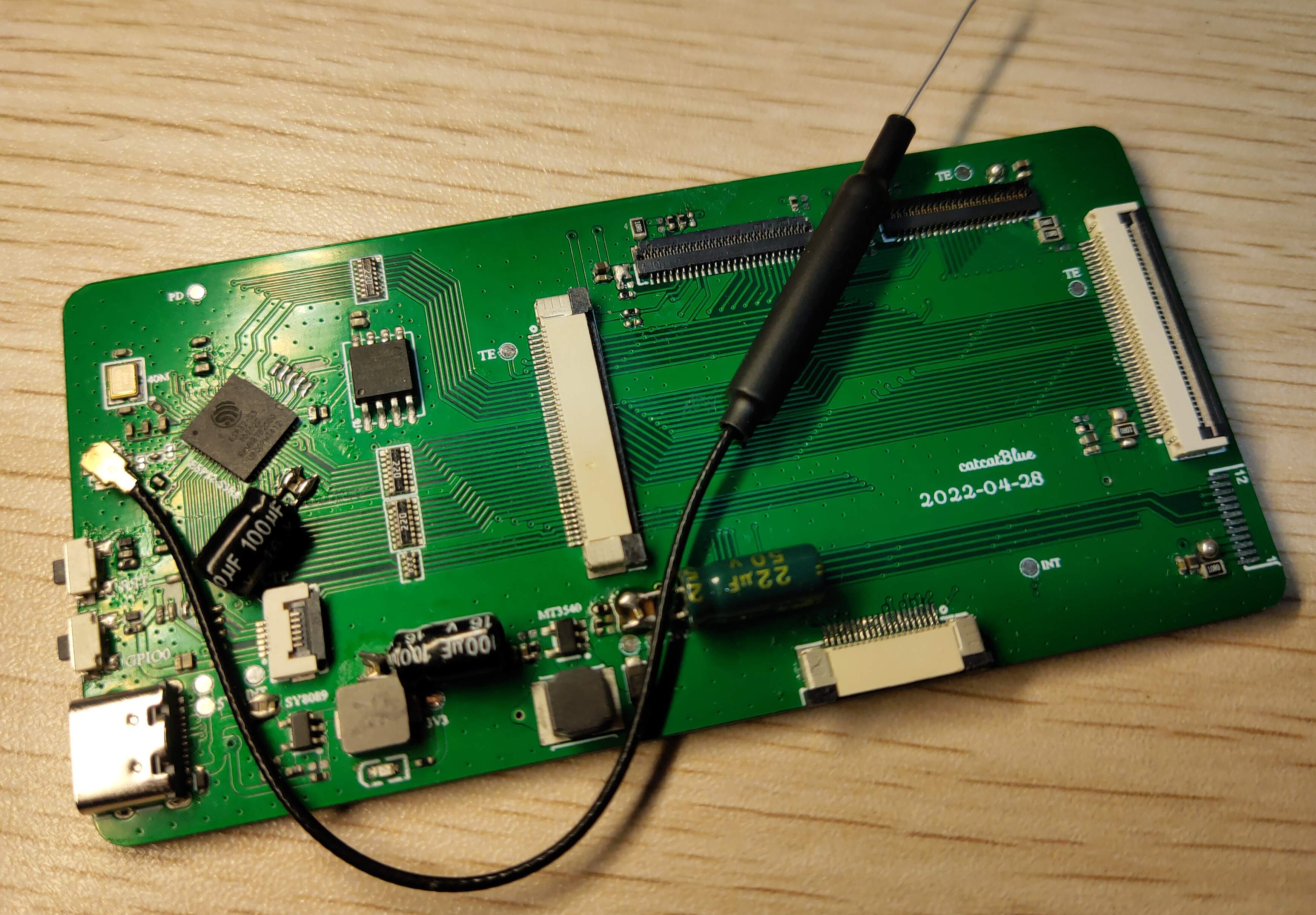

Main control and basic peripherals
ESP32-S3 Minimal System
The main control and basic peripherals are shown in the schematic diagram P1. The minimum system is as follows:
The symbol starting with SC (Short Circuit) in the figure is a short contact. Its usage is the same as that of a 0 ohm resistor. You can consider pasting a 0 ohm resistor or directly shorting it with tin. The schematic symbols and packaging are as shown in the figure below. :
The schematic diagram mainly refers to the ESP32-S3-WROOM-1U module schematic diagram. The main features are as follows:
  • The main control chip uses ESP32-S3R8.
  • The PCB on-board antenna is not used, and the IPEX first-generation antenna interface is used.
  • Flash uses two packages: SOIC-8_208mil and WSON-8_8x6mm, which can be easily expanded to 32MB.
  • Use more filter capacitors
ESP32-S3 basic peripherals
It mainly consists of filter circuit, reset circuit, power indicator light, GPIO0 button (multiplexed with SCL of I2C bus), Type-C USB interface, external serial port, and 0 ohm resistor.
The corresponding relationship between the GPIO and the screen interface can be clearly seen through the 0 ohm resistor.
There is no built-in USB to serial port module, but the USB analog serial port provided by ESP32-S3 provides JTAG debugging and serial port functions.
System power is provided through the SY8089A1AAC DC-DC step-down.
The symbols starting with the bit number TP (Test Point, test point) are test points; the symbols starting with the bit number NC (None Connect, no connection) are reserved bits, which can usually be left blank.

ESP32-S3 part
Focus on referring to the " ESP32S3 Series Hardware Design Guide ". I have no relevant experience in radio frequency, and the layout is for reference only. Part of the layout of ESP32-S3 is as follows:
main feature:
  • The crystal oscillator should be kept as far away from the ESP32-S3 chip as possible, and there should be dense holes around the crystal oscillator to prevent interference.
  • The RF surface traces are surrounded by dense holes; 50Ω impedance matching is performed based on the JLC7628 structure; the π-type matching circuit is retained; and truncated lines are added. The impedance is calculated as follows:
  • There are dense holes around the flash, and the signal lines are routed through the inner layer 2 as much as possible, and the ground is wrapped.
  • The power supply is connected in star connection.
