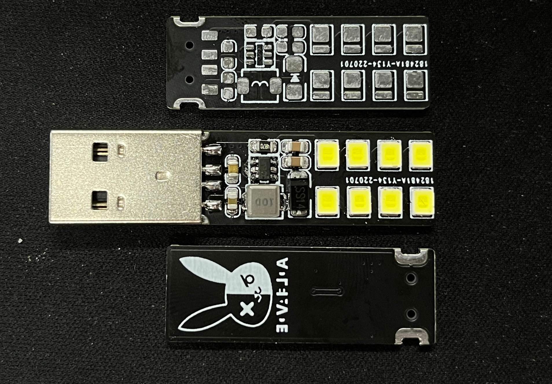

I have the following three major purposes in drawing PCB:
1. [Cuteness is too big]: It means that the size of the PCB should be as small as possible
2. [Obsessive-compulsive disorder friendly]: Align and align! If not aligned, you will die!
3. [The Stubbornness of 0805]: I am blind and only solder devices above 0805 (hum).
The design goal is to make a small USB lamp.
It is driven by a DC-DC constant current scheme.
The boost IC is RY3730 from Ruiyuan Semiconductor. .The
link to Lichuang Mall is https://item.szlcsc.com/344519.html
, where R1 is the current feedback resistor. The calculation method is R=0.25V/Iled. For
PCB project files, see the attached
circuit diagram preview,
PCB wiring,
PCB front and back 3D preview The actual power consumption
of the final product can be optimized: 1. One input and output capacitor is enough 2. The freewheeling diode can be S4 packaged in SOD-323, which is enough
