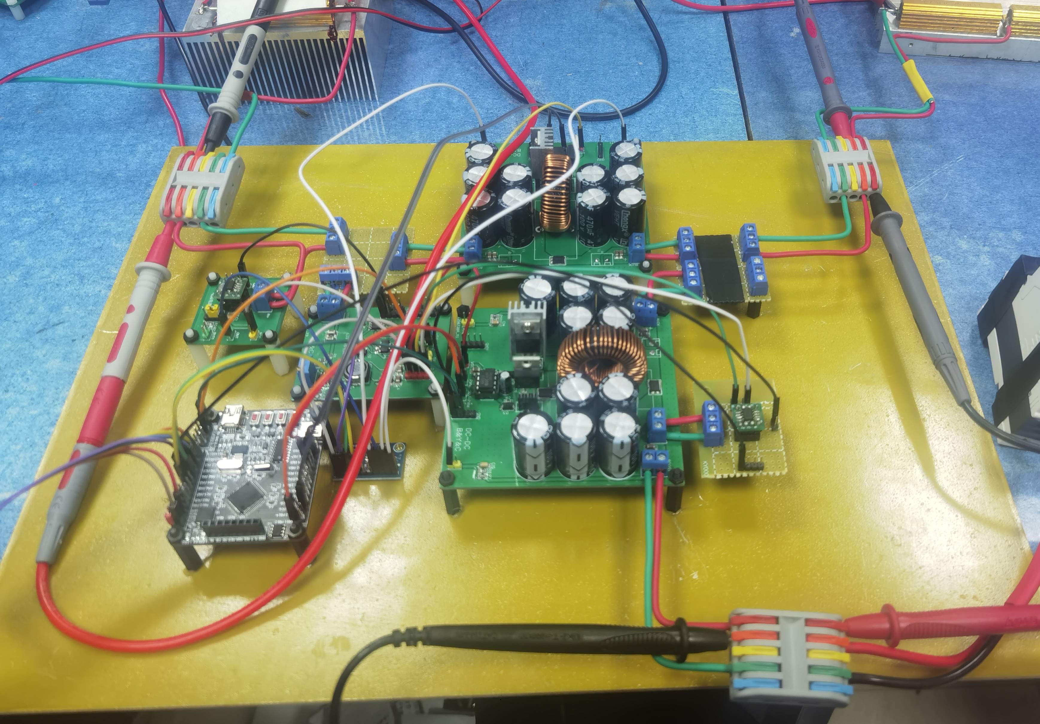

## **6. Physical display**
![613687BD827B97B2C7CB45469A656ED9.jpg ]
### See the attachment for the demonstration video~~~~
