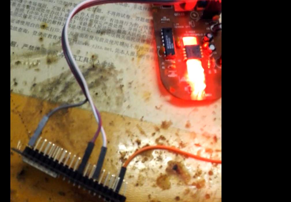

Use esp32-c3 module or esp32-s module to convert ps2 keyboard and mouse to bluetooth keyboard and mouse.
Prepare to change the red dot removed from ibm to bluetooth.
The conversion of ps2 mouse has been completed, and the keyboard still needs to be found... After testing, it is still very smooth, and it is generally no problem to use. The only thing left
is drawing the board. It has not been verified on c3, but it has been successfully tested on wroom32 (see the program in the attachment).
The verification of the c3 board here will take time, and it may need to be verified after the call for submissions ends (college entrance examination is coming). So don't make a board yet, you can use an ordinary esp32 development board to burn the program first. Experience
test video: I used a mouse board, I'm too lazy to put the shell on it.
