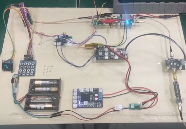

Physical display,
transmitter part,
receiver part,
summary.
  After four days and three nights of hard work, our work has basically met all the requirements of the competition questions, and was completed on the last day. A successful digital transfer was achieved in the afternoon with just a few hours remaining before the game. In the subsequent evaluation, the full function of the work was also brought into play, and it achieved good evaluation results, and then won the first prize in the country. During these four days, we fully understood ourselves and felt tired and nervous with everyone. Sweat and joy accompanied us. After participating in the electronic design competition, we truly felt the challenges of life, felt the urgency of time, and learned to race against time.
