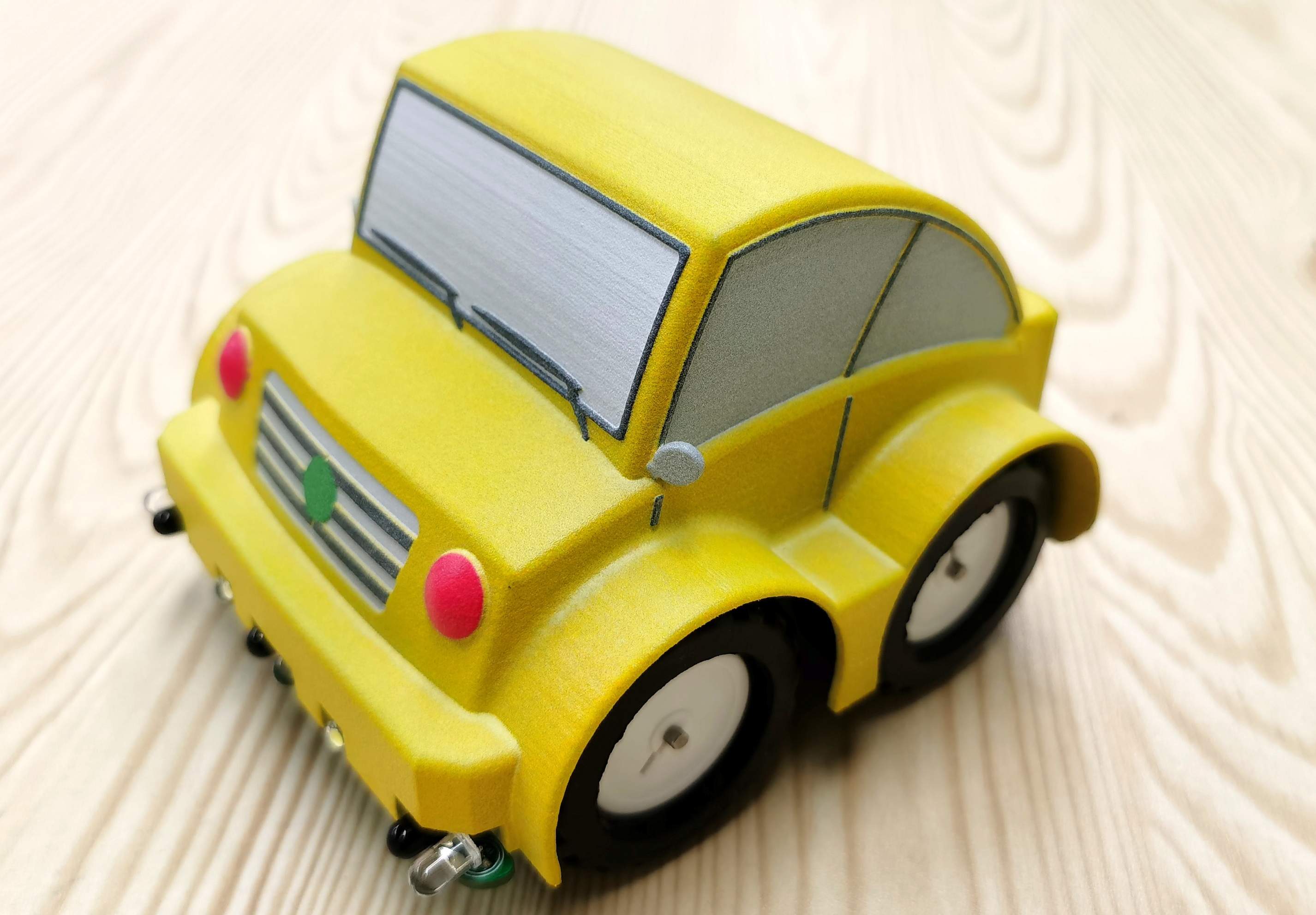

Design a PCB board within 10*10 based on the STM32F103C8T6 core board, which is convenient for students to design and prototype by themselves for 5 yuan, to create a small and exquisite one, teaching students to learn from circuit principle analysis, schematic design, PCB design, welding and code debugging, independently Complete a smart car with tracking and obstacle avoidance functions (in addition, remote control testing and other functions can be added).

(7) The car comes with a matching 3D shell file, making it easy for students to design customized shells.
(If you need to modify the model file, please download the SLDPRT format file; if you want to print directly, please download the STL format file.)
