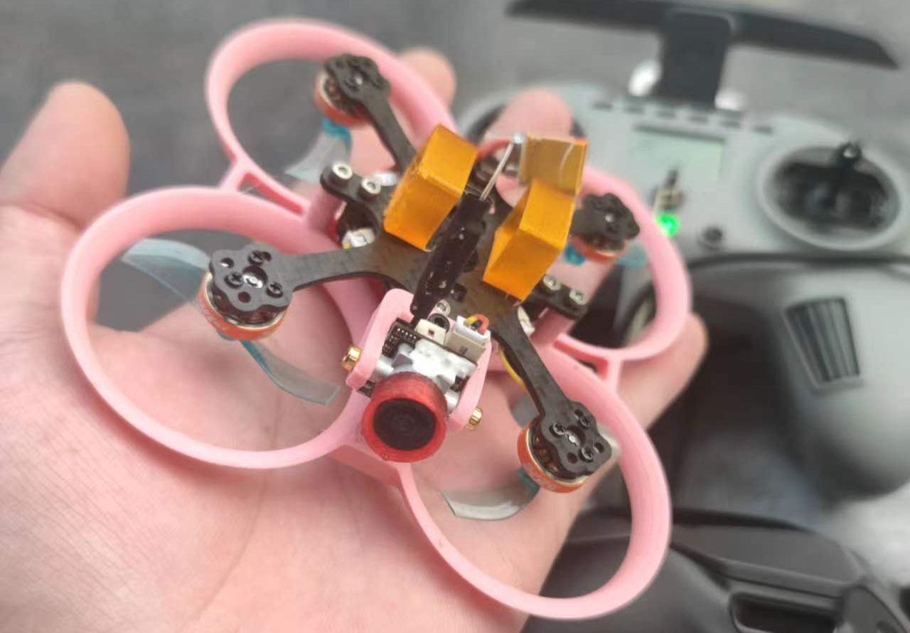

1.6inch ring machine frame
Use PCB to build a board circle frame, 1.6-inch 2s is used, very violent recommended configuration: 1.1002 or 1103 or 1202.5 motor, kv10000-14000 2. Flight control happymodel x12 or betafpv f411aio12A1-2s flight control or darwinf411aio3. Two blades of 1.6inch Blade propeller 4. Camera caddx ant5. Image transmission within 400mw small image transmission (Huagulong dart openvtx betafpv small image transmission) 6. Battery 2s 300-600mah (1103 6000-8000kv optional 3s450mah)
The following are design drawings and physical drawing
attachments In the middle is the STL print, including the circle, battery holder, camera holder, bottom plate closing cover, etc.
