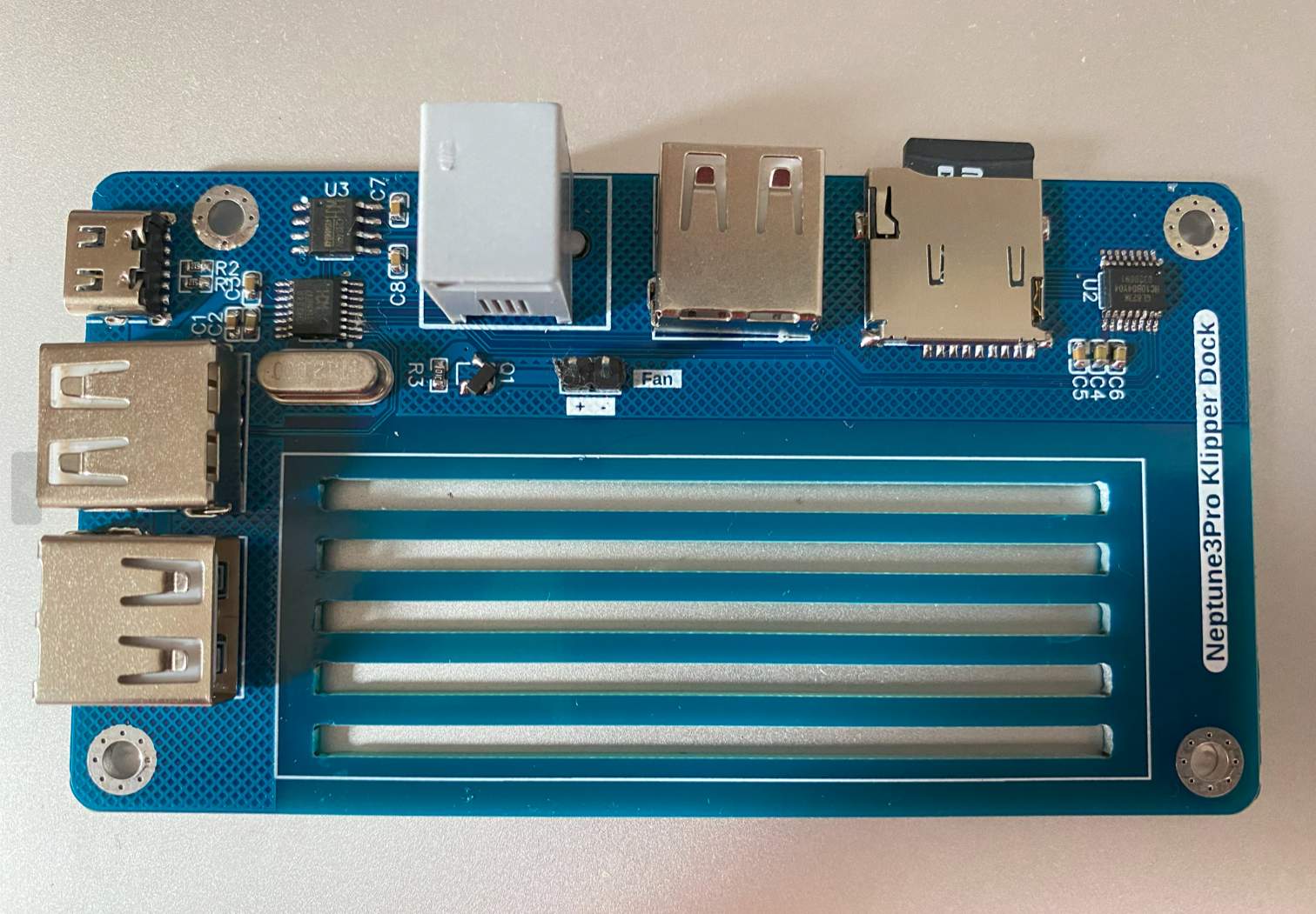

## Basic functions
* USB Hub uses CH334R and supports MTT mode. Compared with the SL2.1a STT mode used in most projects, it has higher performance
* Integrated TF card slot (the portable WIFI capacity is small, and it is available for 3D printing) TF card, eliminating the need to buy a USB flash drive)
* Integrated USB to serial port and Neptune 3Pro screen interface, which can be directly plugged into the screen (Neptune screen will be launched later to perfectly adapt to klipper screen firmware and klipper plug-in)
* 5V interface is reserved Used to connect the cooling fan, this interface can control the fan to turn on and off through the program
## Finished product display
![1.png] ![IMG_0097.jpg] ![2.png]
See the attachment for components
