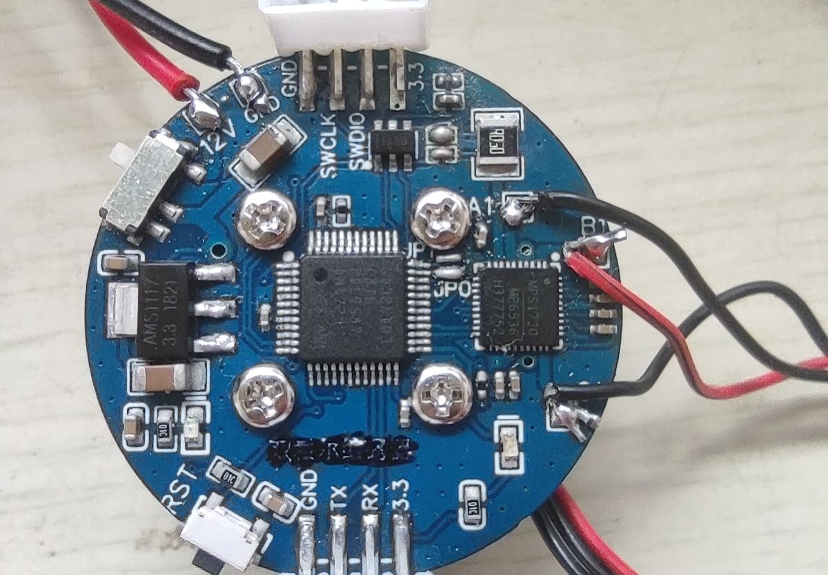

【CW32】CW32F030 gimbal motor 6.1
CW32F030 PTZ motor driver: Sampling CW32F030 as the main control, TLE5012 encoder sampling SPI connection. For current sampling, low-end sampling is used, two-phase A and B low-end currents are collected, and the sampling op amp samples the INA181N2 op amp that amplifies 50 times. Driver chip, using MP6536 driver chip
参考设计图片
