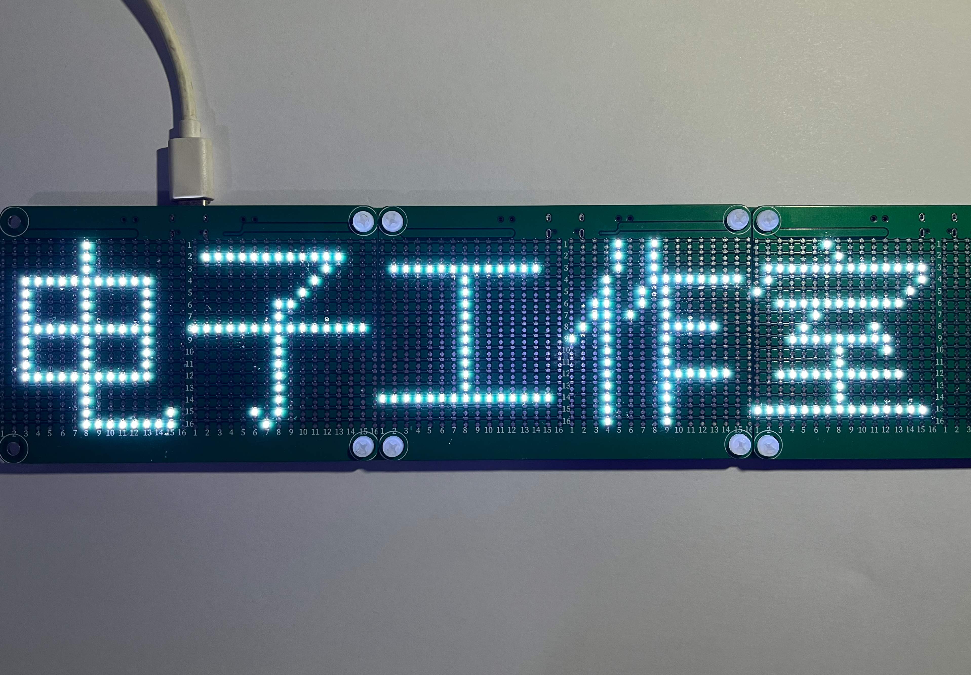

have been playing with lights for a long time and have designed many light strips and dot matrix modules. However, the name of my account has not been displayed yet, so I made this light board that can display fixed Chinese characters. Of course, this fixation is completed during welding. In reality, many situations are still fixed, such as the name of a store.
Fixed has the advantage of fixed, no controller is required, the circuit is simpler, and the reliability of the circuit is increased.
1-Design scheme introduction
This design uses 0603 packaged LEDs, which is a common package I use, and this package is acceptable for hand welding. Each Chinese character is displayed with a 16*16 dot matrix. This is a common operation. Generally, this size is used when playing with LCD screens. This size can display more Chinese characters. Of course, 11*11 can also display a lot, but I don’t really want to use this size.
After we have selected the number of LEDs, we can then distribute the array in the PCB and roughly determine the size of the board. Because I found that one dot matrix did not take up the full 10*10cm size, so I made two. At this time, the adjustment of the LED spacing is to control the length of the board.
When the number of LEDs is determined, the front of the board has actually been determined. The rest of the circuit is also very simple. For the current limiting resistor of the LED, I used the method of distinguishing the left and right half screens, so that which Chinese character can be controlled separately. At the same time, the number of LEDs for each Chinese character is different, and the current limiting resistors they need are also different. (In order to ensure uniform brightness).
As for the power supply of the board, the commonly used TYPE-C package is used, using 16PIN. The two boards can be directly connected and powered through the connection unit. One TYPE-C port can power all boards.

After receiving the PCB, the connection unit under the board should be cut off. Then it is the welding of the PCB. A TYPE-C is welded on the back (only one board needs to be welded), and then a switch is welded to the part that needs to be displayed (if a switch is not needed, a flying wire can be short-circuited). The capacitor can be left unwelded, and the resistor welding is referred to below.
The welding of the LED is the most time-consuming part. Use the Chinese character modeling software to generate a 16*16 dot matrix pattern of the LED, and then weld the LED according to this pattern. Pay special attention to the position and do not weld the wrong row. If the welding is wrong, it can be removed. The soldering of LED can only be done one by one with a soldering iron. First, tin a point on the LED to be soldered, then use tweezers to clamp the LED, melt the solder, put the LED on, and finally solder the other end of the LED. Pay special attention to the spatial order of soldering to avoid accidentally removing the LED next to it because of soldering the LED.
Finally, the double boards are spliced. The screws used here are M3*6 specifications (M3*5 is just right), and nylon materials can be used, or metal can also be used. Put the connection unit under the double board and tighten the screws. In most cases, a good connection can be obtained. If the connection is not good, it is recommended to add tin to the connection unit (a small amount, do not affect the flatness and holes).

LED resistance calculation is actually a relatively simple thing. In this circuit, we connect multiple resistors in parallel to share power. We need to calculate the power output ourselves to avoid excessive current and burn out the resistors. We calculate the resistance to keep the brightness of all LEDs basically consistent.
Our power supply is 5V, and the resistor voltage + LED voltage is 5V. I use a white light LED + 10K resistor, and the LED voltage is 2.57V to light up (I can accept the brightness at this voltage). At this time, the resistor voltage is 2.43, so the current through the LED is 0.243mA (resistor voltage divided by circuit current). We want to display the word "electricity". There are 65 LEDs in parallel, and the total current is 65*0.243=15.8mA.
Then the current limiting resistor value of the word "electricity" is 2.43V/15.8mA=153 ohms. We can get 153 ohms by connecting multiple resistors in parallel.
However, in the actual welding process, the resistor I used is 470 ohms, and 5 are welded in parallel. At this time, the resistance value is 94 ohms.
The selected line in the figure is the result of dividing the number of LEDs by 13. The result can be rounded off, so the corresponding number is the number of welded resistors (the resistance values ​​of the resistors I use here are all equal). If the resistance values ​​are different, you can calculate it yourself.
Another question is whether the resistor can withstand this power. I didn't consider this because the current in my circuit is very small. If the current in your circuit is large, you must consider it to avoid burning the resistor. Theoretically, the power of 0603 resistor is 1/10W, and the power of 10 resistors with the same resistance value in parallel should be 1W.

Problem 1, CC line cannot supply power.
Solution, change AC line
Problem 2, so many LEDs in parallel will have different conduction voltages and uneven light emission due to different LED physiques.
Solution, remove the darkest one and replace it with a new one.
Problem 3, the LEDs are not bright after soldering.
Solution, some LEDs may be short-circuited, burn the short-circuited LEDs, and then remove them. Demonstration video: https://www.bilibili.com/video/BV1Y54y1f7Jy/
