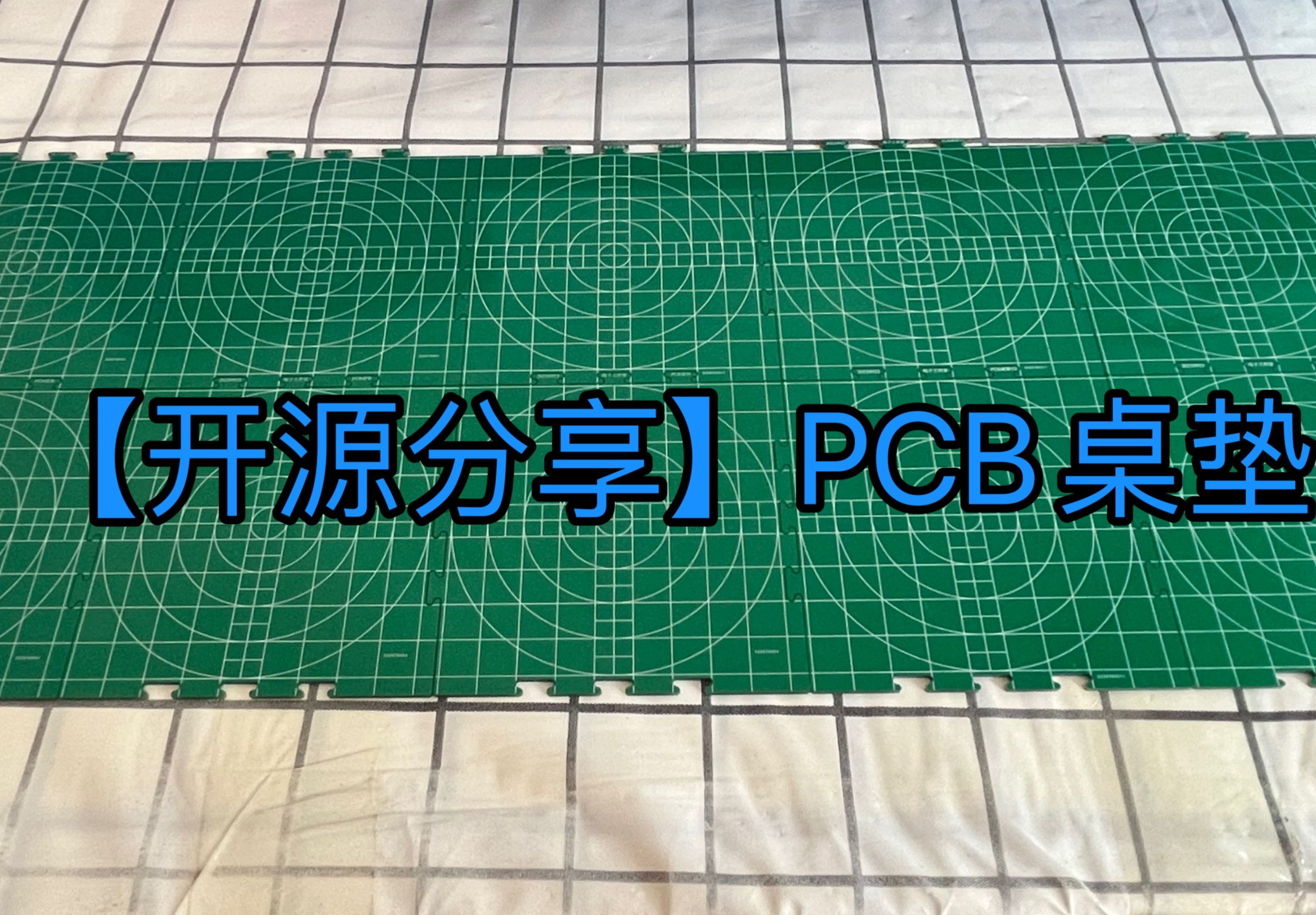

PCB desk mat
Copper is laid on both sides of the table mat. There is a small GND via hole on the upper left side of the PCB. If the PCB needs to be punched twice, adding an extra via hole will prevent the order from being detected. The silk screen of the PCB can be modified by yourself.
Uses of PCB table mat:
1. The soldering iron is not afraid of burning the table.
Problems with the current table mat:
1. The edges are not properly processed
. 2. The splicing is not so tight and requires tape on the back.
I will not change this issue for the time being, because it is already sufficient for use. Those with obsessive-compulsive disorder can refer to other table mat designs.
