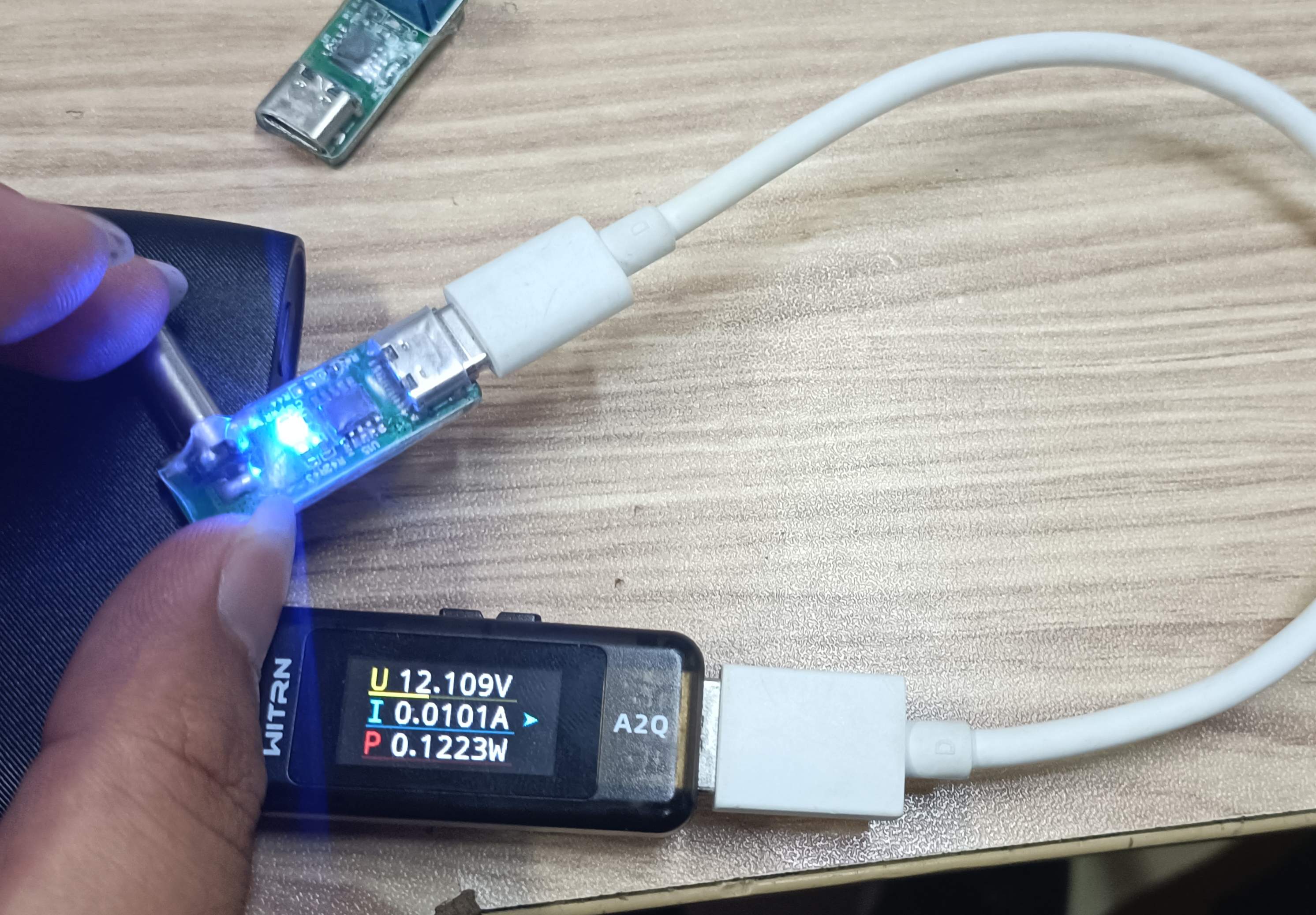

PD/QC decoy
The PD/QC decoy device designed based on CH224K has no problem with the actual measured 20V3A 60W; no matter how high it is, there is no charging head. Select the voltage range by replacing the resistor.
R2 resistance voltage 6.8K 9V 24K 12V 56K 15V NC 20V
length is as long as the DC port of an AA battery
. Buy this kind. The measured 5.5*2.5 is universal.
