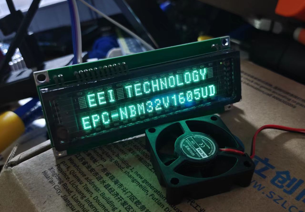

# EEI TECHNOLOGY 05P-FLUORITE Series CIG25-1605N VFD 16x2 character VFD display module
* **Has a wide voltage input range of 4.5-15V. **
* **Adaptive 3.3V/5V level (compatible with 51, STM32 and other mainstream microcontrollers). **
* **Improved power supply and filament driving scheme, no whistling and more efficient. **
* **The VFD screen has a built-in timing controller, which effectively avoids screen burn-in caused by improper use. **
* **1024 levels of brightness adjustable. **
* **SPI communication only requires 5 wires to drive. **
* **Ultra-low power consumption, the maximum power consumption is about 0.8W (full lighting, 1024 brightness, 5V input). **
* ** Built-in ASCII font library, you only need to send instructions to the screen to complete the display. **
* **89x37mm ultra-small size**

## Finished product picture
![image.png] ![image.png]
