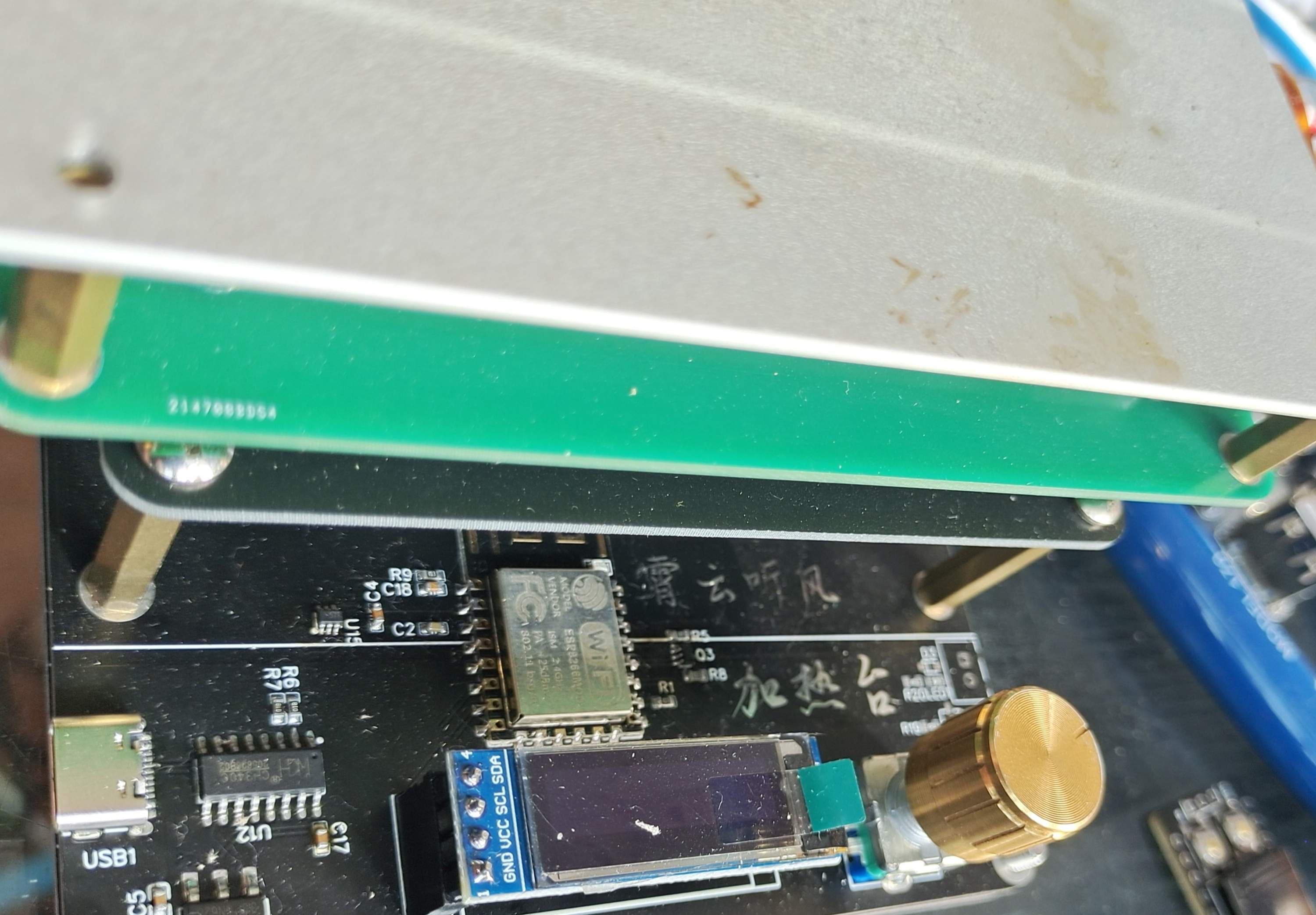

ESP8266 heating stage
According to the transformation of Qifan Science and Technology, the PCB layout and wiring are optimized, especially the high-current lines are thickened, and the windows are opened and tinned to ensure high-power load. It has been used many times and works very well, but the temperature is not calibrated because there is no thermometer. It can be used normally at about 170 degrees.
Software part reference: (can be programmed directly) https://oshwhub.com/dhx233/pcb-heng-wen-jia-re-tai
Heating plate: You can buy this for ntc thermistor, and it only costs a few cents and comes with free shipping:
参考设计图片
