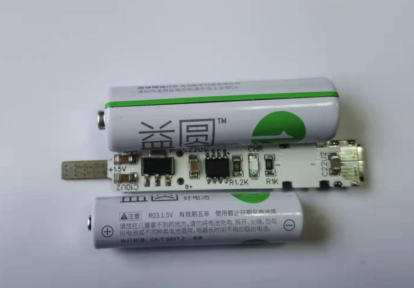

       For the 1.5V wireless keyboard and mouse on hand, the batteries will need to be replaced after a while, because they are planned to be modified to a charging solution that can be plugged into TYPE-C for charging. In fact, you can directly purchase the finished module and modify it, but you need to disassemble the keyboard and mouse to disassemble and modify the interior, which may cause damage to the internal space.
      This project is to make the chipset look like a battery, which can be directly inserted into the battery slot and used with a micro battery, or with a large battery in the available space of the device.
      The charging management chip is TP4056A, so it only supports 5V1A. Further modifications can be made by adding a wireless charging module, so that in the future you can simply place the mouse on the wireless charging mat when not in use.
      Because I am handicapped, I use 1206 patches to widen the patch spacing for easier welding.
      Actual use: After pasting the components on the board, according to whether you need AA or AA batteries, cut them according to the instructions in the PCB diagram, and then directly weld the back of the cut piece to the space left on the back of the board to form a Just the battery frame. It should be noted that after cutting, you need to scrape off about 1mm of the exposed 5V+ pole on the back of the board to avoid short circuit. The external board of the Type-C interface serves as the 1.5V negative electrode, and the actual standby loss has not been measured (no tools are available).
     Attached is an example of an AA battery I made (the lithium battery is a small battery I picked up on the roadside before, with only 280mah. This is just a demonstration)
Comparison with actual AA battery
