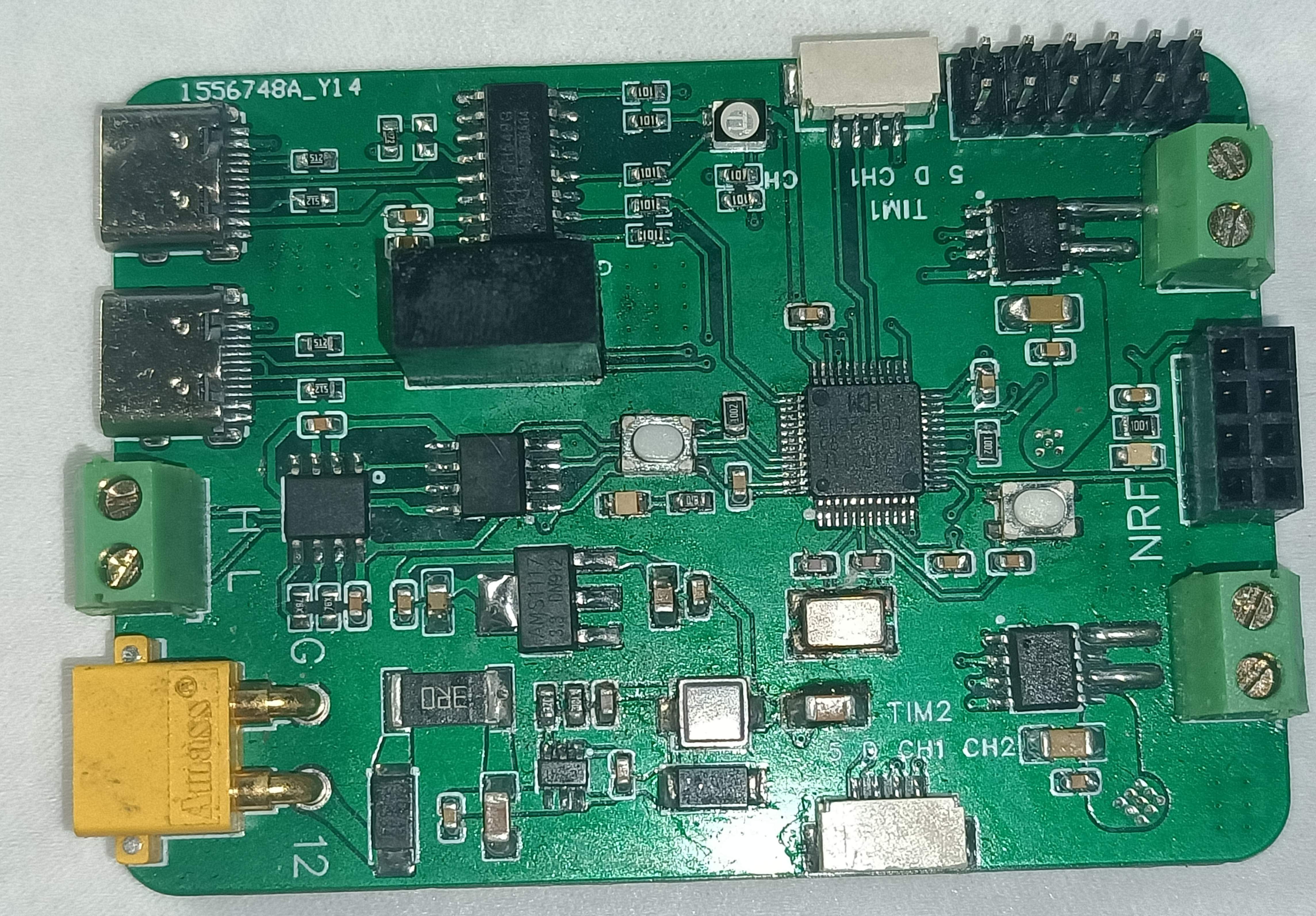

The board uses the then cheap CH32F203 microcontroller, and now there is a cheaper CH32V203 available (manual funny
board with isolated CAN communication interface, wireless NRF interface, integrated downloader, very convenient, can directly use 12 or 24v battery to power the board and drive 2 DC motors in a closed loop, AT8236 is a single-chip integrated H-bridge chip, continuous current up to 4A, peak current up to 6A, and has overcurrent protection, there is no need to worry about burning. The
extra pins are led out, and the pins are all timer channels, which is also very convenient
(some personal information is deleted on the silk screen, but it is still domineering)
The peripherals are very simple, so no routine code is provided, you are
welcome to write it yourself
